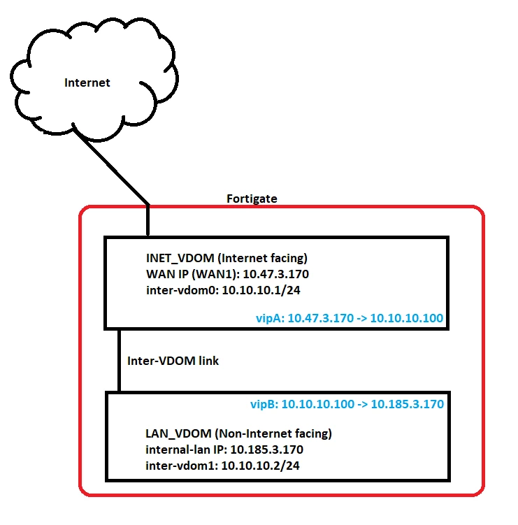

Topology:
INET_VDOM -> Internet facing VDOM
LAN_VDOM -> VDOM with no Internet; LAN VDOM.
Goal:
The result wanted is to reach the internal-lan IP (10.185.3.170) from the External IP (10.47.3.170) where the traffic VIPs through an inter-VDOM IP. The same Inter-VDOM IP will be used in the VIP of both VDOMs; double NAT.

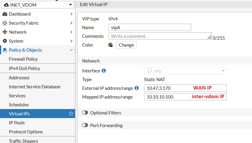

Create a VIP object on the Internet-facing VDOM, vipA: 10.47.3.170 -> 10.10.10.100.
This VIP maps the external IP to an inter-VDOM IP, in this demonstration, 10.10.10.100 will be used.

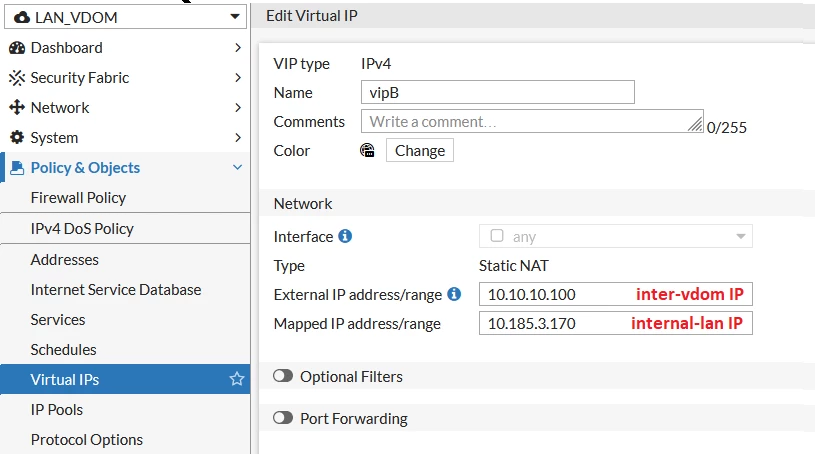

Then, create a VIP object on the Non-Internet facing VDOM, vipB: 10.10.10.100 -> 10.185.3.170. This VIP maps the inter-VDOM IP mapped in vipA, to the actual internal-lan IP, 10.185.3.170.
Note.
The usage of SD-WAN does not matter because only 1 External IP for VIP purposes is used.

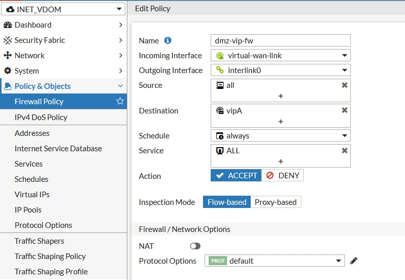

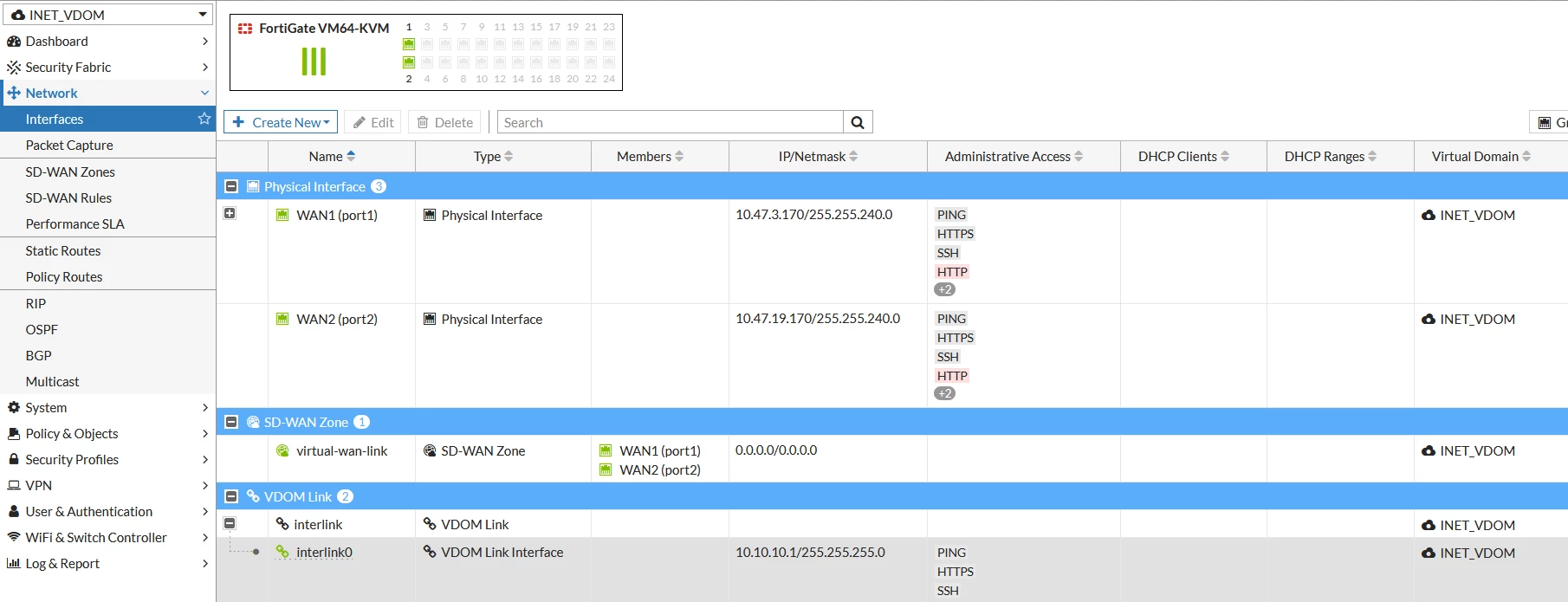

INET_VDOM (Internet facing VDOM) configuration:
Interface:
VIP Object:
Note.
Any IP can be chosen as long as it's within the inter-VDOM IP range that is specified in Interfaces.
Ensure inter-VDOM IP used in both VIP Objects of both VDOMs are the same.
Firewall Policy:
-No Static Route configuration is required here.

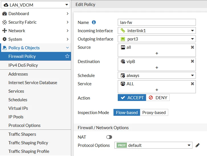

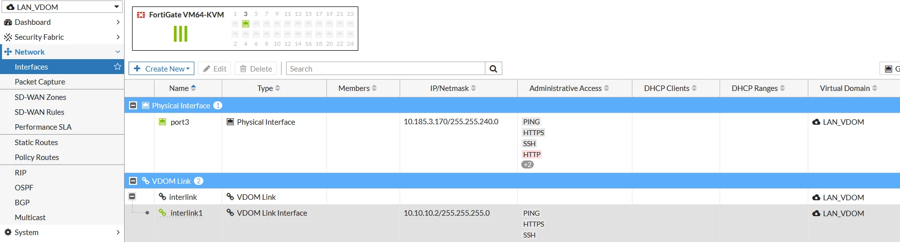

LAN_VDOM (Non-Internet facing VDOM) configuration:
Interface:
VIP Object:
Note.
Firewall Policy:

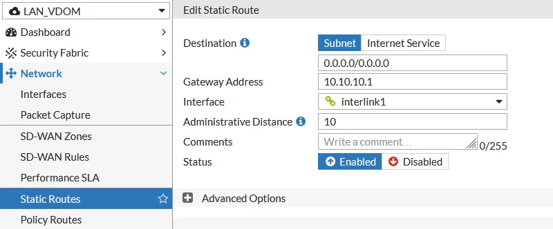

Static Route:
Note.
The static route is required here to ensure the traffic gets routed back through the Inter-VDOM link.
For the Gateway IP, use the inter-VDOM link IP of inter-VDOM0 on the INET_VDOM.

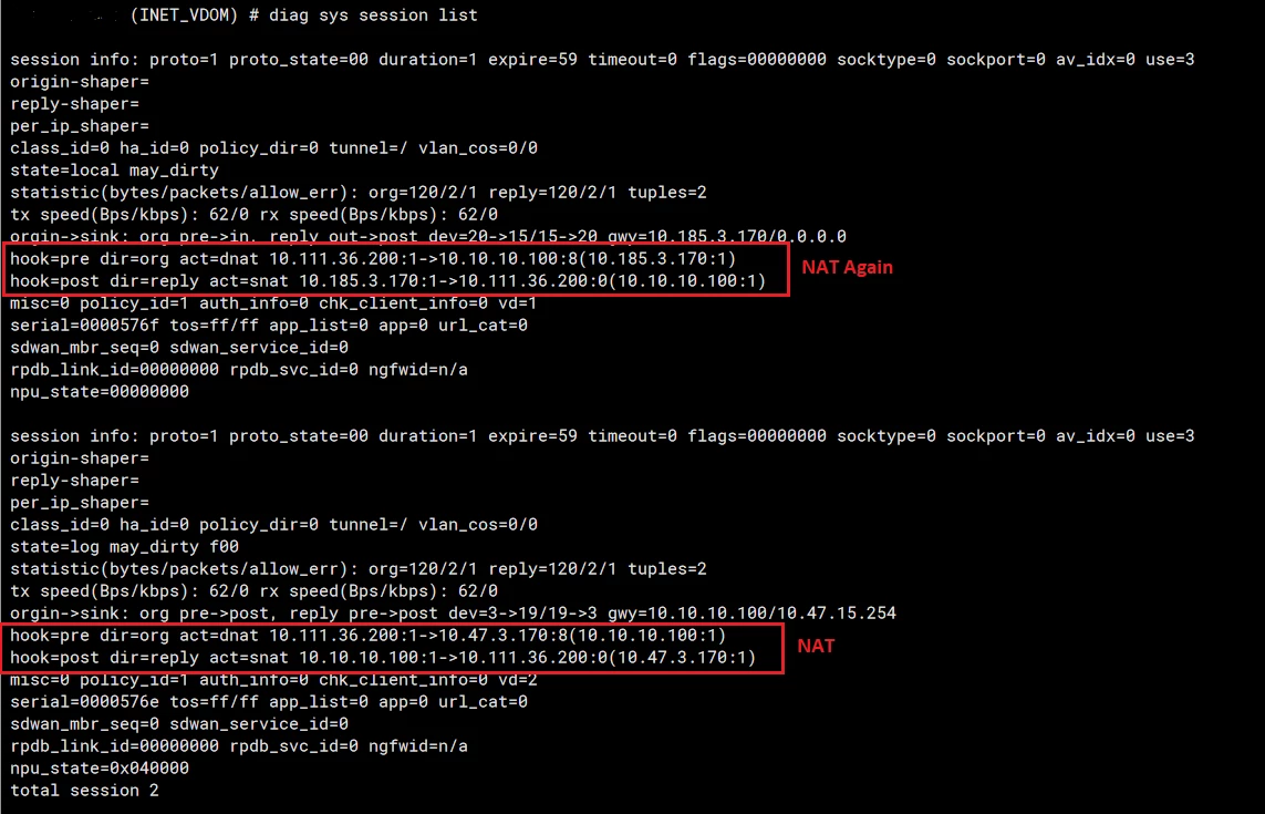

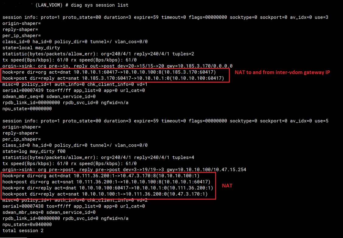

Result:
This is how the Session Table should look like.
Session Table Filters used:
# diag sys session filter ext-dst 10.47.3.170 -> wan ip
# diag sys session filter ext-dst 10.185.3.170 -> internal-lan ip
# diag sys session filter ext-dst 10.10.10.100 -> inter-vdom ip
# diag sys session list
In this screenshot, 10.111.36.200 is the IP pinging the WAN IP of INET_VDOM.

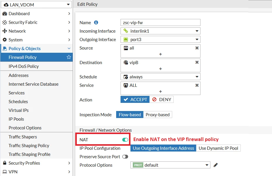

Method 2.
In Method 2, no Static Routes to the Inter-VDOM links on either VDOMs are required.
The configurations are exactly the same except that SNAT is enabled on the VIP firewall policies.
INET_VDOM Firewall Policy:
LAN_VDOM Firewall Policy:
How does it work.
1) Traffic from external that hits the wan ip, 10.47.3.170 will get translated to 10.10.10.100 on the INET_VDOM.
Traffic passes through the inter-VDOM link.
2) Traffic from the inter-VDOM link then hits the LAN_VDOM's inter-VDOM IP, 10.10.10.100, which then gets translated to 10.185.3.170.
3) The reason why a Static Route is not required here is that the return traffic will then be translated by the SNAT from 10.185.3.170 to 10.10.10.100, which then passes back through the inter-VDOM link gateway, 10.10.10.1, back to the INET_VDOM and out through the wan link.
Result:
# diag sys session filter ext-dst 10.10.10.100 -> inter-VDOM ip
