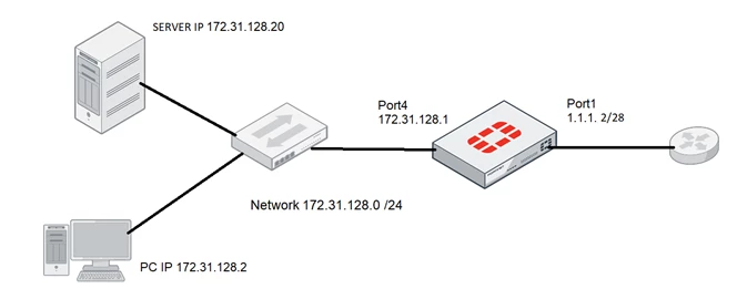

In this scenario, both PC and server are behind FortiGate connected to the network 172.31.128.0 /24 via PORT4.
PC(172.31.128.2) wants to connect to the server by pointing to its external address (1.1.1.1) instead of its real one (172.31.128.20).
FortiGate is connected LAN network 172.31.128.0 /24 via PORT4.
FortiGate is configured with a VIP with an external IP of 1.1.1.1 mapped to the internal server 172.31.128.20.
