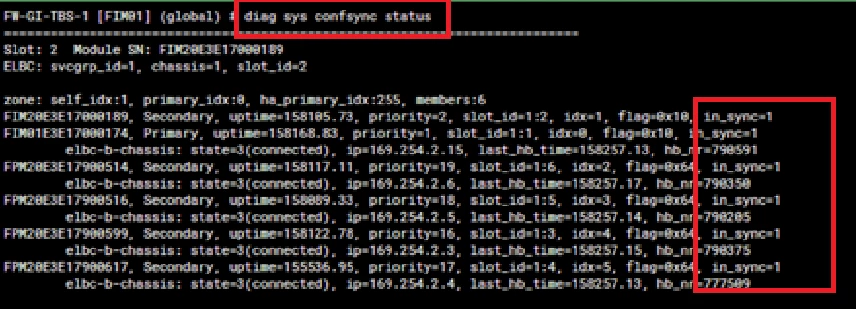

Description This article explains how to check if the FortiGate Interface Module (FIM) and FortiGate Processing Module (FPM) are in sync. This command can be included as part of a health check for the FortiGate-6000/7000 series chassis.
Scope FortiGate-6000 and 7000 series.
Solution To check the in_sync status, access the FortiGate via SSH or use the built-in CLI, then execute the following command:
diagnose sys confsync status

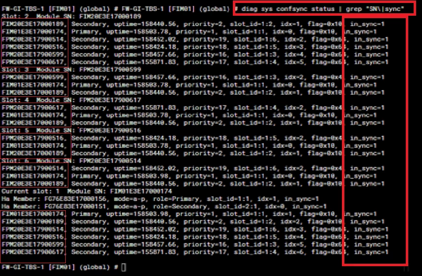

To filter the output and display only the FIM serial number and sync status, use:
diagnose sys confsync status | grep "SN\|sync"
Sample Output:
