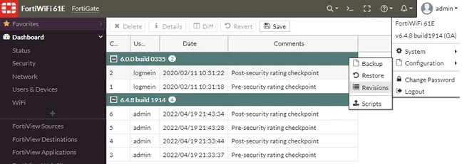

The available revisions can be accessed from the GUI as shown below:
Alternatively, they can be accessed in the CLI:

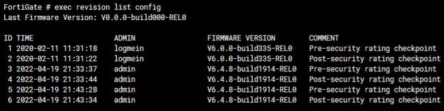

  1. To check the available configuration revisions and the associated revision IDs:
execute revision list config

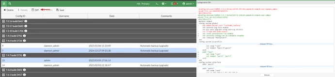

This feature can be used to compare the configuration changes and revert the FortiGate to the previous configuration in the event of a configuration loss in the current state.
To compare the configurations, choose the two versions and select the 'Diff' button:

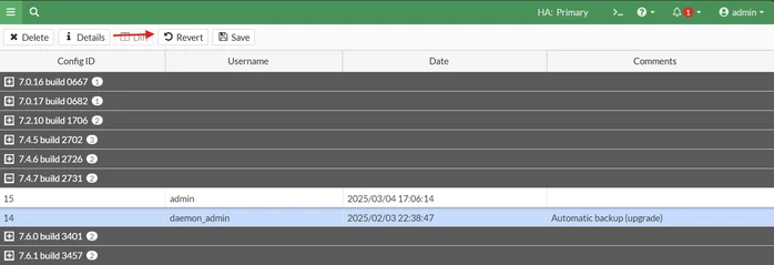

To revert to the previous configuration, choose the correct version and select the 'Revert' button:
Configuration restoration can also be performed from the CLI using the following command (the Revision ID can be obtained from the output of 'execute revision list config':
execute restore config flash <Revision_ID>
