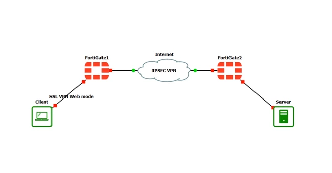

With that in mind, consider the following topology, which includes an IPsec VPN tunnel used by the SSL VPN host FortiGate (FortiGate1) to reach the remote Server:
Topology:
To visit the remote server, check and confirm that the following have been configured:

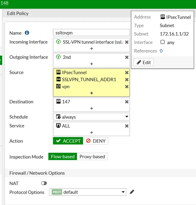

  1.  Ensure that an SSL VPN Firewall Policy exists to allow traffic to the remote resource.
Despite SSL VPN web mode traffic being technically local-out (FortiGate initiating a connection to the remote resource), it is still a part of SSL VPN, and so it requires a Firewall Policy to govern access for users to the remote resource. With that in mind, ensure that Firewall Policies exist that allow traffic to flow from the SSL VPN interface to the outgoing interface (in this case,e the VPN tunnel interface) along with the appropriate Source Address, Source User/Group, and Destination Address.

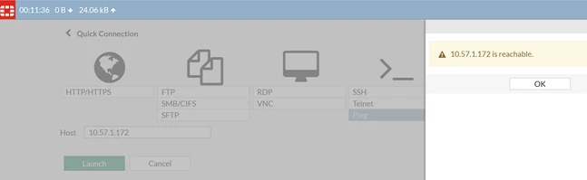

With all three requirements satisfied, the SSL VPN web mode client should be able to use the FortiGate to access the remote resource across the IPsec tunnel successfully.
