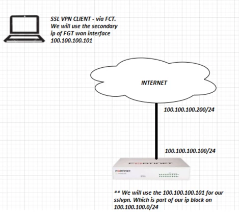

This article describes how to use secondary IP  address of WAN interface / public IP in SSL VPN.
For version 6.2.5.
Diagram.

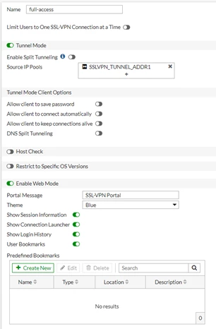

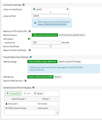

SSL VPN Configuration.

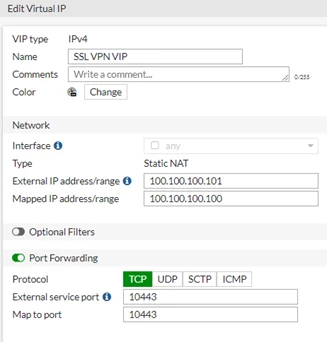

VIP Configuration.

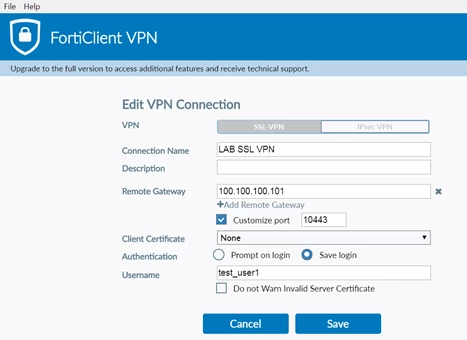

FortiClient Configuration.
Result.
