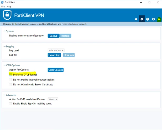

If the user(s) are still using TCP, check FortiClient settings to ensure that the option 'Preferred DTLS Tunnel' is checked in the settings. If the option is greyed out, select the padlock on the top right to unlock it (Screenshot below). See the following FortiClient article for more information: VPN options | FortiClient Administration Guide
When FortiClient is managed by EMS, the DTLS option cannot be enabled directly on the FortiClient console. Changes need to be pushed by the administrator from EMS.

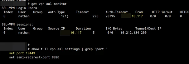

  1. Check the Public IP of the PC connected with FortiClient and the SSL VPN Port.
get vpn ssl monitor
show full vpn ssl settings | grep "port "

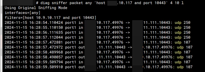

  1. Perform a packet capture with the Public IP and SSL VPN Port. UDP packets should be seen:
diagnose sniffer packet any 'host <PC Public IP> and port <SSLVPN Port>' 4 10 l
