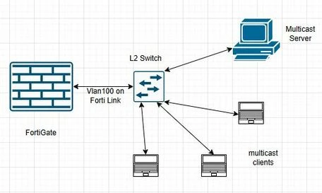

Consider the following diagram:
Based on the diagram, the multicast traffic will reach the FortiGate from the multicast server and will be distributed to clients. This is done using 'block intra-vlan traffic' on VLAN 100, as per the following config.

When the traffic reaches FortiGate, a multicast policy is been used to send the traffic to the ingress interface, which is VLAN 100 on FortiLink.
Based on this, the multicast policy should look like the following, where the source and destination interface are the same (VLAN100). However, the same interface is not supported as both source and destination:
