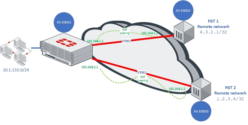

Considering the following scenario:
  • VPN1 and VPN2 are terminated on a non master blade.
  • In the example, the VPN is hosted on FPC4, and the master FortiPrivateCloud is FPC1.
  • BGP peering is established over the IPSEC tunnel.
Information about the worker bound to each VPN can be found here:
FG-6KF (root) # diagnose vpn ike gateway list | grep "name\|LB“
IPSec LB: IKE-master esp-worker: FPC04
Status of the BGP peering could be displayed as well:
FG-6KF (root) # get router info bgp summary
Slot: 1  Module SN: FPC6KFT021900120
VRF 0 BGP router identifier 192.168.2.1, local AS number 65001
Neighbor    V         AS MsgRcvd MsgSent   TblVer  InQ OutQ Up/Down  State/PfxRcd
192.168.1.2 4      65002     236     240        2    0    0 03:25:19        4
192.168.2.2 4      65003     235     238        3    0    0 03:25:24        4
Slot: 3  Module SN: FPC6KFT021900113
Slot: 4  Module SN: FPC6KFT021900073
Slot: 5  Module SN: FPC6KFT021900075
The VPNs are established on FPC4, but the BGP peering is running on FPC1. This traffic debug flow output shows how the BGP traffic is handled by the FPC4.
[FPC04]  id=20085 trace_id=7 func=print_pkt_detail line=6233 msg="vd-root:0 src_slot:4 received a packet(proto=6, 192.168.1.2:6092->192.168.1.1:179) from to-vm1-lo. flag [.], seq 3526966677, ack 395374808, win 11"[FPC04]  id=20085 trace_id=7 func=resolve_ip_tuple_fast line=6337 msg="Find an existing session, id-0005d449, original direction"[FPC04]  id=20085 trace_id=7 func=lb_fpm_localin4 line=1586 msg="forward packet to master-worker slot-1"
The BGP traffic is forwarded by the FPC4 to the FPC1, where it can be processed. The data traffic over the VPN can go through FPC4. Only the BGP traffic will go to FPC1.
