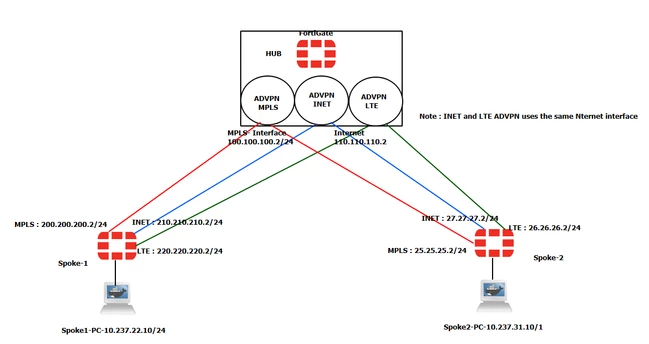

When multiple overlays are used between spokes and a hub, there is a common tendency for shortcuts to be created between different tunnels. This approach has advantages and disadvantages. This article will use the following single hub with 3 ADVPNs and 2 spokes to discuss this.
As shown above, each spoke has 3 overlay links, where one is a MPLS link with private addressing and the other two are internet links from LTE and fiber connections. Upon setting up the ADVPN, the links can be seen as 'up', as shown below in an example hub FortiGate:

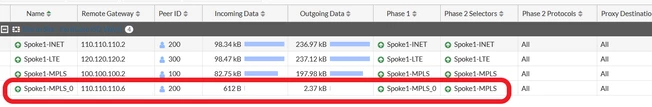

When a device behind spoke 1 tries to reach a device behind spoke 2, a shortcut will be created after the initial negotiation, as shown below.
The outputs from spoke 1 and spoke 2 below show that cross shortcuts have been created between MPLS and INET. Refer the following outputs from the Sp1 and Sp2 FortiGates:
In a real network, shortcuts between MPLS links and internet links will fail because MPLS works on a private domain and internet links working on a public domain. This will cause failures in a live network.
As these examples were created in Fortinet labs and there is no way to separate Internet links from MPLS, they have connectivity. This is why shortcuts are shown between MPLS and INET.
