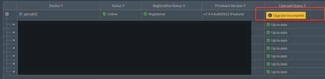

This article describes post upgrading FortiGate could see message 'Upgrade Incomplete' in the Fabric Management page.

If all of the settings are working as expected, cancel the error message:
System -> Fabric Management -> Select the device and choose 'cancel'. The error message will be removed.
If it persists: clear the browser cache and cookies, try another browser, or use incognito mode.
