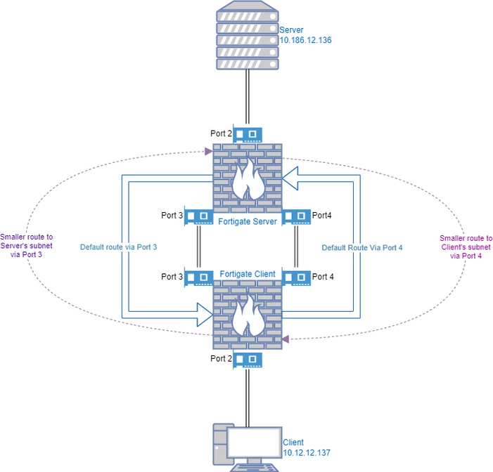

This article describes how routing decisions work in FortiGate with or without asym routing, and with or without an auxiliary session enabled.
FortiGate version 6 and above.
In this scenario, the traffic flows between a Client and a Server passing through two FortiGates.
The client and server are connected to their corresponding FortiGate via Port 2.
The FortiGate Server and FortiGate Client are connected via two links: Port 3 < - > Port 3 and Port 4 < - > Port 4. Each link uses a specific VLAN with specific IP addresses.
Routing table:
FortiGate Client:
  • The default route via Port 4.
  • Specific route for the server’s subnet via Port 3.

FortiGate Server:
  • The default route via port 3.
  • Specific route for the client’s subnet via port 4.

In this scenario, a TCP session will be generated from the client to the server. The return path used will be observed.

For the first packets in Test 1, the FortiGate Server receives the traffic on Port 3. It is forwarded to the client on Port 2.
For the SYN-ACK, the behavior is different. The FortiGate Server sends the traffic towards the FortiGate Client through Port 4. Port 4 is the best route to reach the FortiGate Client from the FortiGate Server.
The reply to the client is based on the best route in the routing table:
  • If the best route is through Port 3, it will egress on Port 3.
  • If the best route is through Port 4, it will egress on Port 4.
No matter where the initial packets are coming from.
Enabling auxiliary sessions allows control over where the return traffic should go. The routing table will be taken into account and not the original incoming interface. Moreover, unlike with asymmetric routing enabled, the FortiGate remains a stateful Firewall, and all UTM features can be enabled.

The first packet is similar to Test 1 and Test 2. The SYN-ACK packet comes from Port 4. The behavior is the same as that with an auxiliary session enabled. The main difference will be related to Hardware Acceleration. Some features do not work when asymmetric routing is enabled.

The behavior of enabling the asym routing in a FortiGate:
Reply Traffic will choose the best route/interface to forward traffic rather than using the same incoming interface ('sticky' behavior).
As a result, the FortiGate checks the routing table to forward the reply, regardless of which interface the packets come from.
Note that if asymmetric routing is enabled, antivirus and intrusion prevention systems will not be effective.
The FortiGate will not detect connections and will process each packet individually through the CPU. This could have an impact on the performance.
FortiGate will behave like a stateless firewall and will not take advantage of the hardware acceleration.
Enabling the asymmetric routing changes how the FortiGate handles the return traffic. Asymmetric routing can affect performance and security behavior.
A better option is to consider using auxiliary-sessions rather than asymmetric routing.
