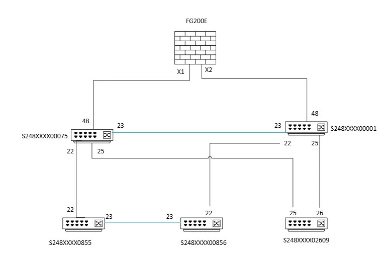

Topology Example:
MCLAG-ICL pair:
  • tier1 pair: S248XXX00075 (port23) <---> (port23) S248XXX00001
  • tier2 pair: S248****0855 (port23) <---> (port23) S248****0856)
Refer to the topology diagram. Connect to the FortiSwitch and review the trunk configuration:
S248*****00075 #show switch trunk
edit "_FlInK1_ICL0_"
    set auto-isl 1
    set fortilink 0
    set isl-fortilink 0
    set mclag-icl enable
    set members "port23"
edit "8*****02609-0"
    set mode lacp-active
    set auto-isl 1
    set fortilink 0
    set isl-fortilink 0
    set mclag enable
    set members "port25"
edit "toCORES_tier-2"
    set auto-isl 1
    set fortilink 0
    set isl-fortilink 0
    set mclag enable
    set members "port22"
edit "G200E********"
    set auto-isl 1
    set fortilink 1
    set isl-fortilink 0
    set mclag enable
    set members "port48"
Explanation of Trunk Types:
'_FlInK1_ICL0_'.
This is an Inter-Chassis Link (ICL) trunk formed automatically between FortiSwitch peers based on the LLDP profile default-auto-mclag-icl.
In the above topology it is formed on port23 of tier1 and tier2 mclag-icl pair.
Note: In older version before lldp profile was introduced one had to manually enable mclag-icl after the auto trunk was formed between pair.
'8*****02609-0'.
This type of trunk is automatically formed on ISL port of connecting FortiSwitch that is not part of an MCLAG ICL pair. The name is derived from the FortiSwitch’s serial number. Here the trunk is formed on S248*****00075 port25 that is connecting to downlink FortiSwitch S248*****02609(non mclag-icl FortiSwitch). Similar trunk is seen on S248*****00001 port25.
Note: If another non mclag-icl FortiSwitch was connected to S248*****02609, the trunk will be formed on both FortiSwitch ISL ports with a name as described above.
'toCORES_tier-2'.
Formed on a uplink MCLAG pair that is connecting to downlink MCLAG pair, with the trunk name sourced from the auto-isl-port-group configuration.
Example configuration on FortiSwitch tier1 :
config switch auto-isl-port-group
        set members port22
'G200E********'.
A trunk formed between a FortiSwitch and the FortiGate, when the fortilink-neighbor-detect setting is configured as FortiLink.
Note: If the setting is configured as lldp, the trunk name may appear as '906CACDECE68-0' instead.
'_FlInK1_MLAG0_'.
Trunk formed on downlink FortiSwitch ports that are connected to an uplink MCLAG pair. For instance, a trunk formed on ports 25 and 26 on S248XXX02609. A similar trunk name is created on S248*****0855 and S248*****0856 port22.
