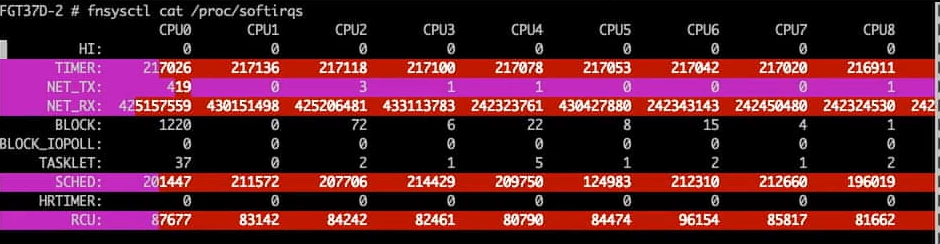

Investigating SoftIRQ subsystems.
To determine which SoftIRQ subsystem is consuming high levels of CPU, analyze '/proc/softirqs':
fnsysctl cat /proc/softirqs
  • HI: High-priority tasks.
  • NET_TX: Packets generated locally.
  • TIMER: Periodic timer functions.
  • NET_RX: Incoming traffic (user packets).
  • SCHEDULER: Task scheduling functions.
Notes:
  • NET_RX is the number of executions per second, not the number of packets. The higher the number of executions, the more packets are processed.
  • NET_TX packets: displays the number related to the execution of transmitted packets.
For instance:
Run the command twice (for example, 10 seconds apart) to calculate the difference and derive per-second values.
NET_RX DIFFERENCE FOR CPU0:
427470114 - 425157559 = 2312555
2312555 / 10 = 231255
This calculation indicates NET_RX executed 231,255 times per second, suggesting a high volume of incoming packets.
