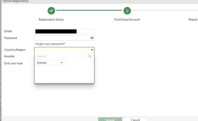

Description This article describes how to troubleshoot an issue where FortiSwitch is not able to register from the FortiGate. Even after entering the username and password, the fields like 'countries' or 'reseller' do not populate, which prevents completing the registration for FortiSwitch.
Scope FortiGate.
When trying to register FortiSwitch from the FortiGate, the fields like countries or reseller do not populate, preventing FortiSwitch registration.
When running the https debug commands, the following error is seen:
diagnose debug application httpsd -1
diagnose debug enable
[httpsd 3496 - 1644506914 error] build_license_forticare_resellers[1240] -- Failed to get reseller list: http_error_code:[0]
This happens if there is an issue with FortiGuard anycast reachability. Disable anycast and try again:
config system fortiguard
    set fortiguard-anycast disable
Alternatively, register from the CLI as follows:
diagnose forticare direct-registration product-registration -N <FAP/FSW-serialnumber> -a <username> -p <password> -T "<country>" -R "reseller" -e 1
