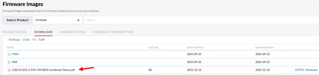

This is due to an issue with a BIOS Certificate Failure that happens specifically on the FortiGate 70G hardware and specific FortiGate firmware versions. Patched versions of FortiOS v7.4.9 and v7.6.4 have been released to FortiGuard. The Customer Support Bulletin for this issue is available in the FortiOS v7.4.9 download folder:
