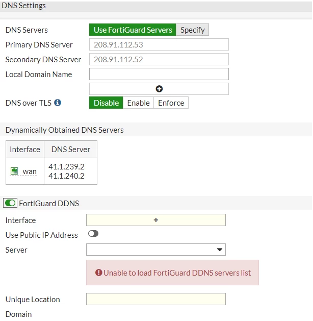

Technical Tip: Unable to load FortiGuard DDNS server list
  • August 16, 2020
  • 6 replies
  • 70706 views
This article describes how to use the DDNS service and how to enable FortiGuard DDN servers when the following error message appears from the GUI:
FortiGate.
  1. If there is a PPPoE or DHCP connection on the WAN port, make sure the overriding internal DNS is disabled:
  • From the GUI, go to Network -> Interfaces, edit WAN, and unselect Override internal DNS.
  • From CLI/SSH:
config system interface
    edit wan1
        set dns-server-override disable

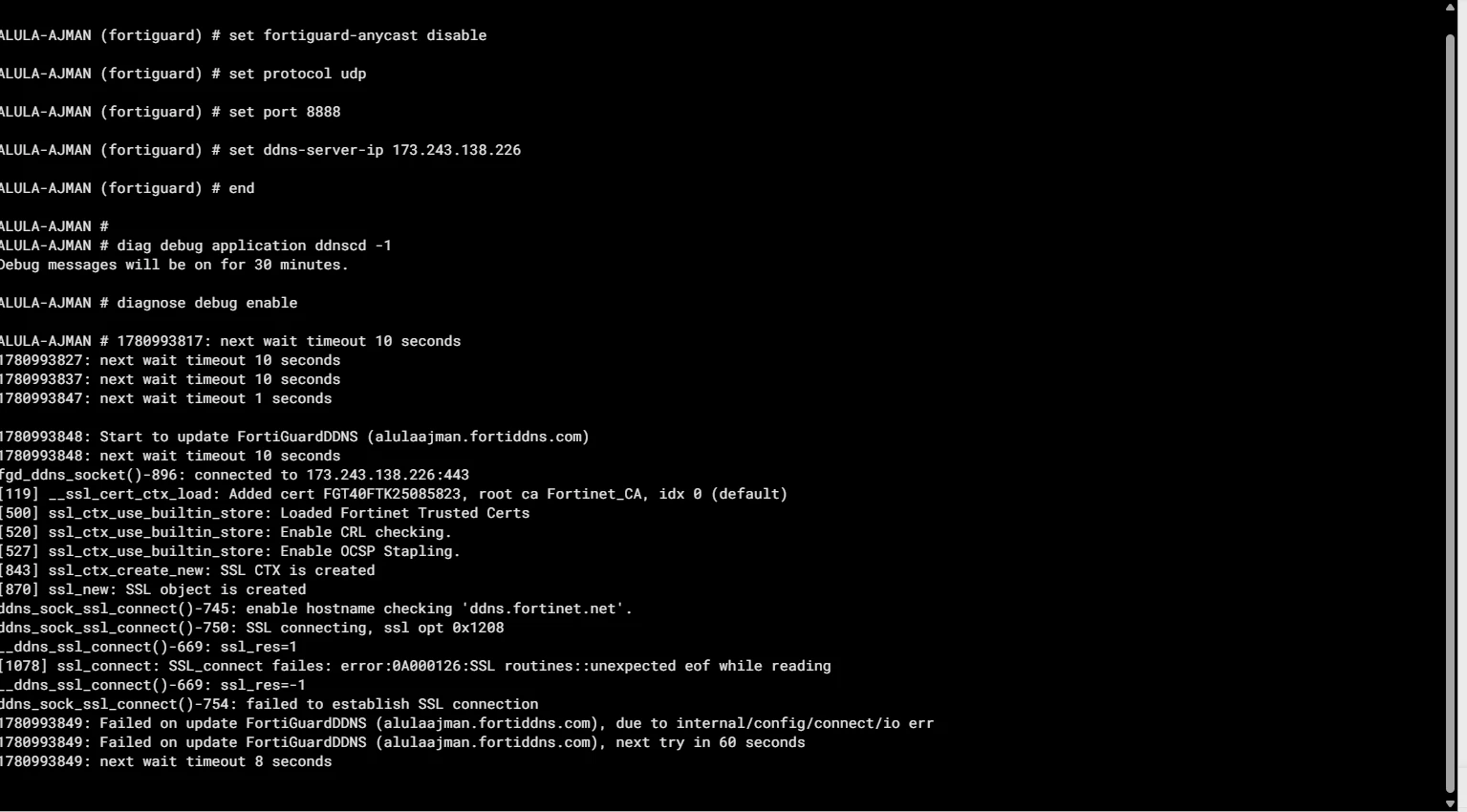

    I have the same issue. It started after upgrading the FortiGate firmware to 7.2.13.
    I tried the suggested steps, but the issue is still present. The FortiGate cannot load the FortiGuard DDNS servers list, and FortiDDNS is not updating the hostname.
    Debugging ddnscd shows a certificate verification problem:
    Certificate verification failed
    self-signed certificate in certificate chain
    SSL_connect fails
    Failed on update FortiGuardDDNS
    Internet access from the FortiGate works, FortiGuard services seem reachable, and SSL-VPN works when using the current public IP directly. The problem appears to be only with FortiGuard DDNS after the firmware update.

    I had the same issue after upgrading to FortiOS 7.2.13 on a FortiGate 60F.
    FortiGuard DDNS stopped updating and the hostname was still resolving to the old public IP. In Network > DNS I was getting “Unable to load FortiGuard DDNS servers list”. Debugging ddnscd showed a certificate verification error / self-signed certificate in certificate chain.
    I tried setting the DDNS server manually:
    config system fortiguard
    set ddns-server-ip 173.243.138.225
    After testing, I removed it again:
    unset ddns-server-ip
    After that, FortiGuard DDNS started working again and the hostname updated correctly. I did not change anything else.
