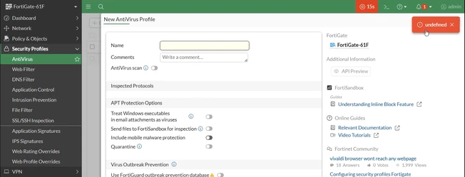

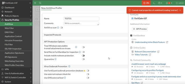

This article describes an issue where an Anti-virus security profile cannot be created via the GUI on the lower-end models with 2GB RAM post firmware upgrade to v7.6.1.
FortiGate v7.6.1.
Anti-Virus security profile cannot be created via the GUI on devices with 2GB RAM, particularly on lower-end models with the below errors.
This issue has been resolved in FortiOS version 7.6.3.
Workaround:
Configure the Anti-virus security profile using the CLI option.
