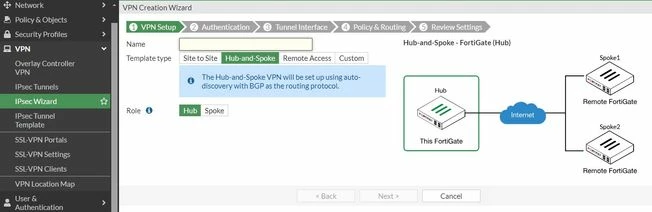

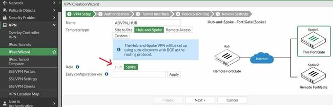

This article describes an issue where the HUB option is greyed out when creating an ADVPN setup using IPSec Wizard.
Scope FortiOS.

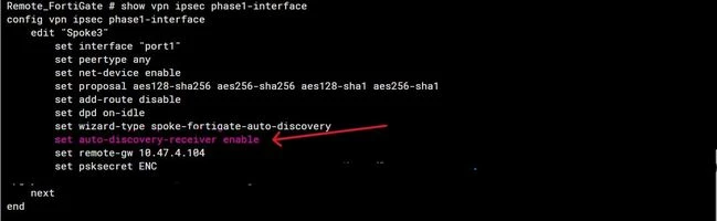

This is due to a Spoke configuration that is still present on the IPSec VPN configuration of the FortiGate.
To be able to select the HUB template, auto-discovery-receiver must be disabled.
    edit <VPN_Name>
        set auto-discovery-receiver disable
Or:
Delete the whole IPSec VPN phase1-interface configuration.
Note: All the references of the IPSec Phase1-interface must be deleted first for us to be able to delete the whole IPSec Phase1-interface tunnel including the Firewall policies and Phase2-interface.
After doing one of the steps above, the HUB template can be selected again on the IPSec Wizard.
