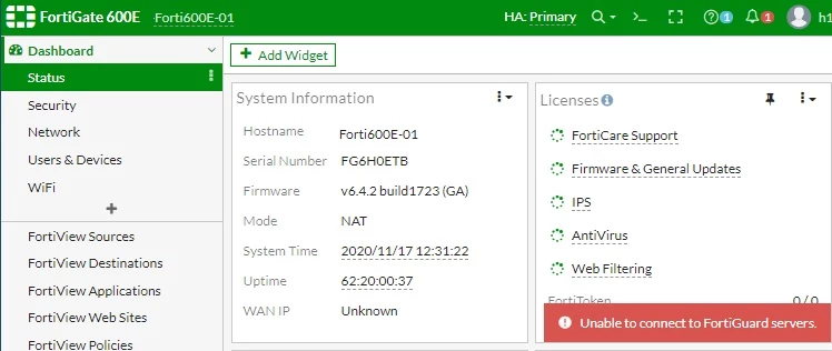

The following error appears under Dashboard -> Status -> Licenses:

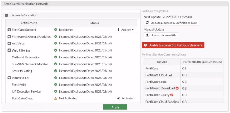

The same message is also shown under System -> FortiGuard -> FortiGuard Updates as below:

The issue is due to the 'cloud-communication' and 'include-default-servers' being disabled in the previous firmware version, and it must be enabled to let FortiGate communicate with FortiGuard located on the internet cloud.
config system global
    set cloud-communication enable
    set include-default-servers enable
