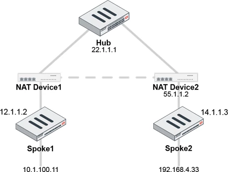

UDP hole punching allows ADVPN shortcuts to be established through a UDP hole on a NAT unit.
The NAT unit has to support RFC 4787 Endpoint-Independent Mapping.
In the following example, unit 10.1.100.11 behind Spoke1 needs to reach unit 192.168.4.33 behind Spoke2. Spoke1 and Spoke2 are behind NAT units and have established IPsec tunnels to the Hub.
The hole punching creates a shortcut between Spoke1 and Spoke2 that bypasses the Hub.
