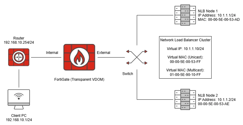

Consider the following example topology:
Configuration Information
  • The Network Load Balancer (NLB) uses a virtual IP and a virtual MAC to which packets are addressed.
  • The virtual IP (example: 10.1.1.10) is unicast, and the virtual MAC is either unicast (example: 00-00-5E-00-53-FF) or multicast (configurable; in this example: 01-00-5E-90-10-FF).
  • The internal Router will send packets to this NLB using either the unicast or multicast MAC address (based on the ARP reply sent back by the NLB cluster).
