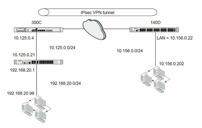

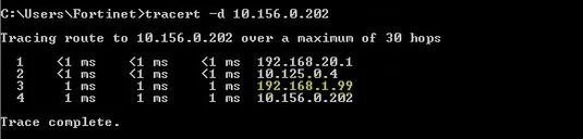

Referring to the diagram above, if tracert/traceroute is performed on PC at 192.168.20.99 to PC at 10.156.0.202 across an IPsec VPN tunnel, the output is as follows:
The issue is that 192.168.1.99 is a 'mgmt' interface; the interface is not connected at all. From a logical point of view, it should be showing IP address 10.156.0.22 since the packet went out through this interface, but this is incorrect. In this article, the IP address 10.156.0.22 is incorrect. How FortiGate selects the IP to respond, and what is the workaround.
Tracert/traceroute packet is based on an increment of the TTL value for each hop the packet traverses. It will start off with TTL value = 1, the first packet will reach 192.168.20.1. Since the TTL is already expired, FortiGate will not perform any routing table lookup to see which interface or next hop to send the packet out. Therefore, FortiGate will use 192.168.20.1 to respond to he tracert/traceroute packet and not 10.125.0.21.
The problem arises when the traceroute is traversing through an IPsec VPN tunnel, in which the IPsec VPN tunnel interface is a logical interface, and often, we do not configure any IP address on that interface. Therefore, in this case, FortiGate responds with the IP address of 192.168.1.99. This is an IP address of the mgmt interface, and the interface is neither up nor connected with any cable. How does FortiGate decide which IP address to respond to? FortiGate will use the IP address of the interface starting from the lowest index value. The index value can be found from the command 'diagnose netlink interface list'.

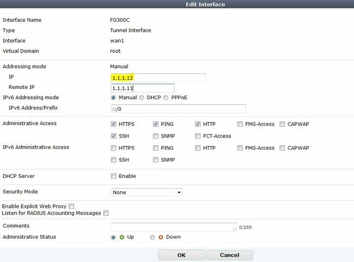

Instead of depending on the index number, you can configure an IP address on the 140D IPsec VPN interface instead, so that the tracert/traceroute is showing the expected IP address.
Via CLI method:
config system interface
    edit "IPsec" <----- Name of the tunnel interface.
        set ip 1.1.1.12 255.255.255.255
        set remote-ip 1.1.1.11 255.255.255.255
        set interface "wan1"

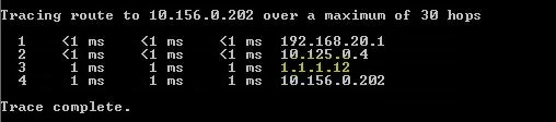

The tracert/traceroute result is shown after configuring the IP address on the 140D IPsec VPN interface.
