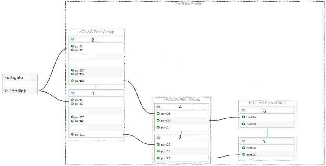

Three-tier FortiLink MCLAG configuration.
To create a three-tier FortiLink MCLAG topology, use FortiOS 6.2.3 GA or later and FortiSwitchOS 6.2.3 GA or later.
To configure the FortiSwitch units in the core:
  1. First, connect the core switches to the FortiGate aggregate interface and connect the link between the core switches (SW 1 and SW 2 in the example above). Both switches will form 2 trunks – one with FortiGate and one ISL (inter-switch link).

    Note: Only the trunks from the higher tier MCLAG-ICL switches to the next tier MCLAG-ICL switches need this configuration.
  5. Add an auto-isl-port-group for the tier-2 MCLAG SW 3 and SW 4 on both the switches SW 1 and SW 2:
    On SW 1:
    config switch auto-isl-port-group
        edit tier-2
            set members port22
    On SW 2:
        edit tier-2
            set members port21
  6. Note: Do not make all the connections at this point. Connect only SW 3 to SW 1 and once SW 3 is online, connect SW 4 to SW 3. Wait for SW4 to come online and then enable mclag icl between SW4 and SW3 - wait for ICL to get established and then connect SW4 to SW2 (similar to point 2, it is necessary to push lldp-profile default-auto-mclag-icl).
  7. Add two auto-isl-port-group for the tier-3 MCLAG switches on both switch SW 3 and switch SW 4:
    On both SW3 and SW4:
        edit tier-3-SW5_6
            set member port20
  8. Now, connect only SW 5 to SW 3 and once SW 5 is online, connect SW 6 to SW 5. Wait for SW6 to come online. Now, enable mclag icl between SW5 and SW6 - wait for ICL to get established and then connect SW6 to SW4 (Similar to point 2, it is necessary to push lldp-profile default-auto-mclag-icl and verify the MCLAG ICL commands).
  9. Verify that all the FortiLinks are up and double-check the MCLAG-ICL configuration on each MCLAG FortiSwitch.
