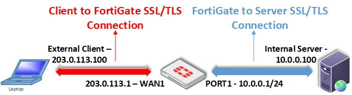

In Full Mode SSL Offloading, there are two separated SSL/TLS connections.
The first SSL/TLS  connection is between a Client and the FortiGate, the second SSL/TLS connection is between the FortiGate and the Server.
For the first connection, the FortiGate is acting as an SSL/TLS server, but for the second connection, the FortiGate is acting as an SSL/TLS client.
There must be at least one matched SSL/TLS version between SSL/TLS client and server on both connections. Otherwise the connection will be terminated.
