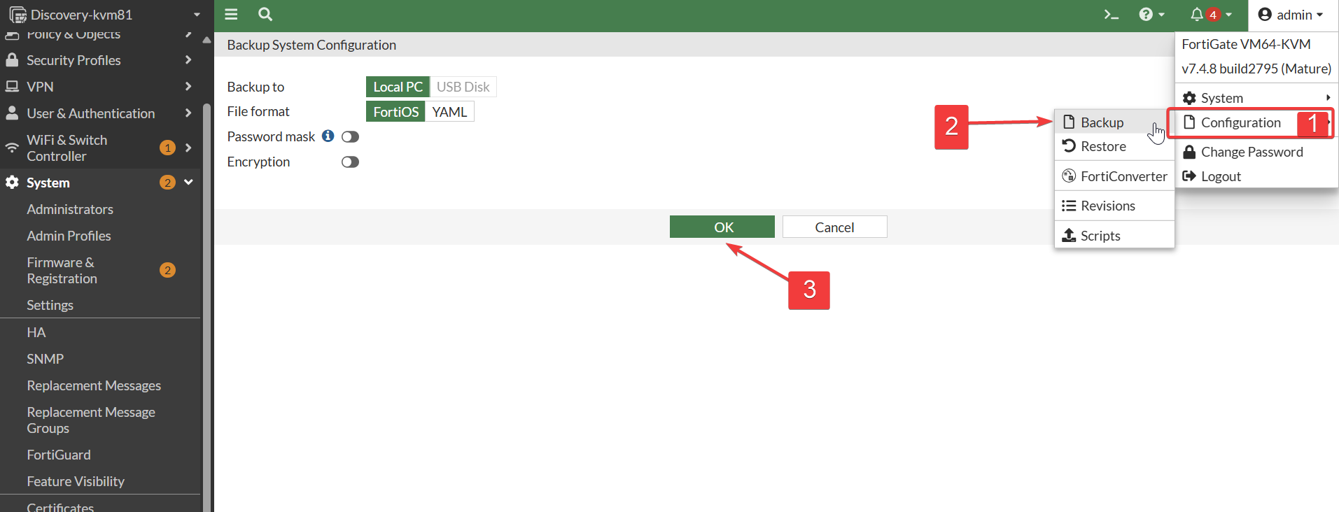

  • Backup the configuration before upgrading.
    • GUI:
      • Select the admin username in the upper right-hand corner of the screen and select Configuration -> Backup. Backup directly to the local PC or to a USB disk.
In the CLI:
execute backup config flash <comment>
execute backup config ftp <backup_filename> <ftp_server>[<:ftp_port>] [<user_name>] [<password>] [<backup_password>]
execute backup config tftp <backup_filename> <tftp_servers> [<backup_password>]
execute backup config sftp <backup_filename> <sftp_server>[<:sftp_port>] <user> <password> [<backup_password>]
execute backup config management-station <comment>
execute backup config usb <backup_filename> [<backup_password>]

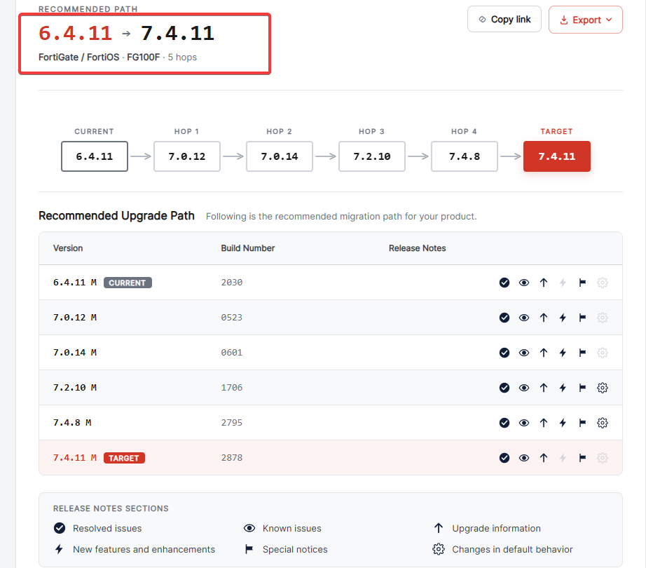

Example upgrade path: FortiGate-100F v6.4.11 to v7.4.11.
Using the Fortinet Upgrade Path Tool, the following sequence may be required: To export the upgrade path information, select the 'Export' drop-down and choose the preferred option, or the information can be saved by using the 'Copy link' option.
"hop" "version" "build_number"
"current" "6.4.11 M" "2030"
"hop 1" "7.0.12 M" "0523"
"hop 2" "7.0.14 M" "0601"
"hop 3" "7.2.10 M" "1706"
"hop 4" "7.4.8 M" "2795"
"target" "7.4.11 M" "2878"
Verify upgrade path link: Upgrade Path Tool Table. Each step ensures configuration consistency and system stability.
