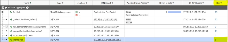

For example, with a VLAN:
The VLAN 'Traffic_vlan' has one reference, which is an address object.

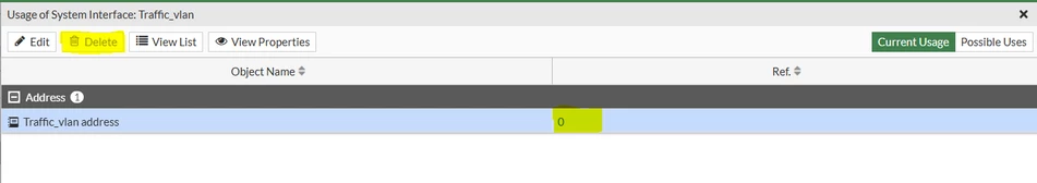

Despite having zero references for the address object, it shows as grayed out.

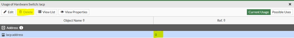

With a Hardware Switch:

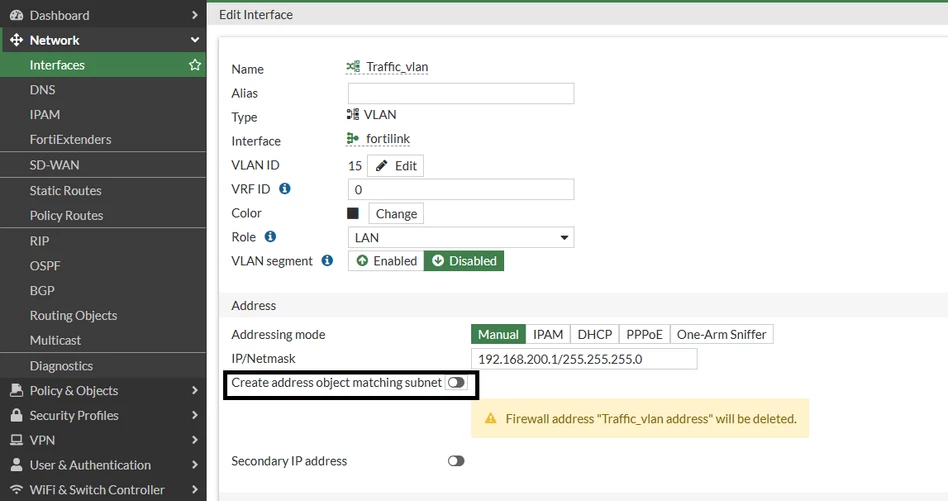

Option 1:
Disable the 'Create address object matching subnet' option in the interface section; this will remove the address object. The 'Create address object matching subnet' is only available in the GUI when the interface role is set to LAN or DMZ.

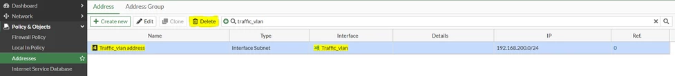

Option 2:
Delete the address object by navigating to Policy & Objects -> Addresses, searching for the name, and then deleting the address object.
