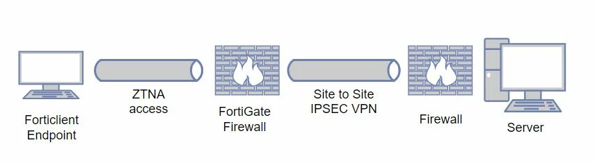

This article describes how to configure a FortiGate to forward a TCP connection (RDP or other protocols) received through ZTNA access when the destination virtual server is behind a site-to-site VPN.
Scope FortiOS v7.2.0+, v7.4.0+, v7.6.0+.
When this topology is implemented:
The FortiClient Endpoint sends RDP connections to the FortiGate via ZTNA. Upon receiving the traffic, the FortiGate checks if ZTNA access is permitted.
If allowed, FortiGate forwards the traffic through the IPsec tunnel. However, by default, the firewall uses the outgoing interface IP address as the source IP, which can cause the tunnel to drop the packet.
Therefore, it is crucial to implement source NAT and ensure the packet has a source IP address within the local subnet of the VPN.
