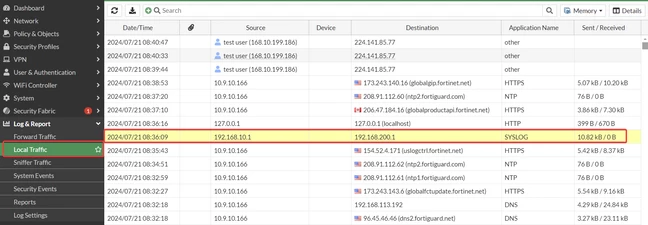

  2. Verifying the logs under Local traffic is also possible as the syslog traffic is self-generated. Below is an example screenshot of Syslog logs. 192.168.10.1 is the source IP specified under syslogd LAN interface and 192.168.200.1 is the remote syslog server IP.
