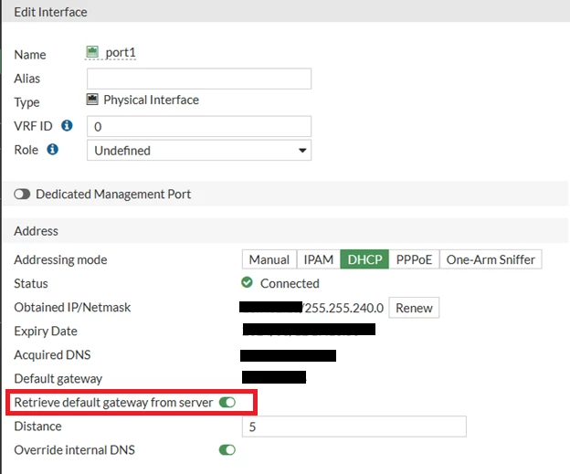

The routing table shows as below when the 'defaultgw' option from CLI is enabled on the interface, it is seen to have a default route installed in the routing table by itself.

From the GUI the same option is known as 'retrieve default gateway'.
To add the static route manually for them, first, set the interface to not get the Dynamic Gateway by disabling the 'defaultgw' from the CLI or by disabling 'Retrieve default gateway from server' from the GUI:

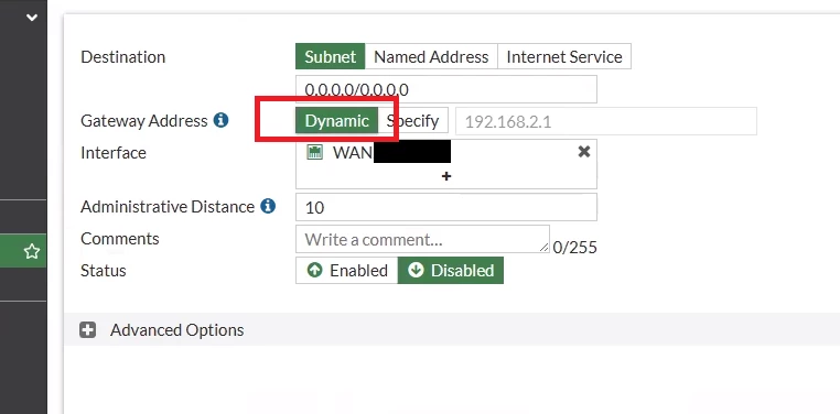

Now configure the static route either via the CLI or GUI:
CLI:
config router static
        set dynamic-gateway enable
        set device <interface name>
GUI:
The picture shown above is for the example DHCP interface, and the routing table shown below is an example taken for the PPPoE interface.
The routing table shows the following entry after adding a static route entry:

In this way, the dynamic-gateway hides the gateway variable for a dynamic interface, such as a DHCP or PPPoE interface.
When the interface connects or disconnects, the corresponding routing entries are updated to reflect the change by itself.
