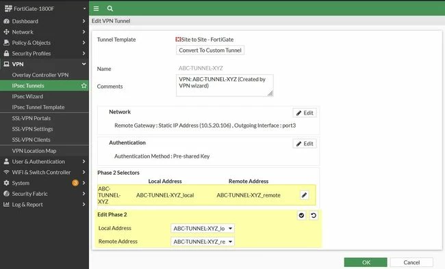

Configure IPSec VPN using Wizard:
From CLI:
    edit "ABC-TUNNEL-XYZ"
        set interface "port3"
        set peertype any
        set net-device disable
        set proposal aes128-sha256 aes256-sha256 aes128-sha1 aes256-sha1
        set comments "VPN: ABC-TUNNEL-XYZ (Created by VPN wizard)"
        set wizard-type static-fortigate
        set remote-gw 10.5.20.106
        set psksecret ENC ehpZslaquEarMvK
        set phase1name "ABC-TUNNEL-XYZ"
        set proposal aes128-sha1 aes256-sha1 aes128-sha256 aes256-sha256 aes128gcm aes256gcm chacha20poly1305
        set src-addr-type name
        set dst-addr-type name
        set src-name "ABC-TUNNEL-XYZ_local"
        set dst-name "ABC-TUNNEL-XYZ_remote"
The destination Address is added automatically to static route as below:

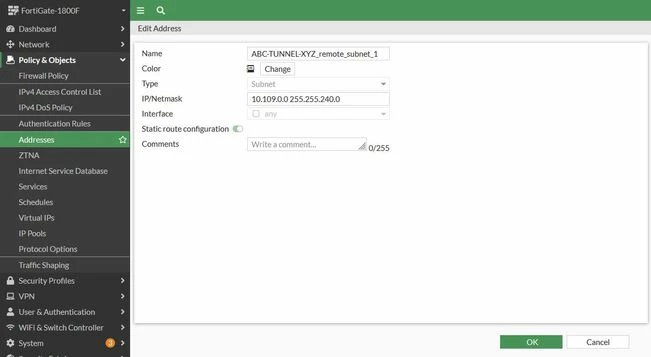

config firewall address
    edit "ABC-TUNNEL-XYZ_remote_subnet_1"
        set uuid 9f593496-8ae8-51ef-b219-f8824328139f
        set allow-routing enable  -->
        set subnet 10.109.0.0 255.255.240.0

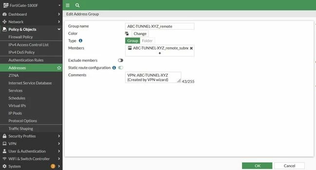

config firewall addrgrp
    edit "ABC-TUNNEL-XYZ_remote"
        set uuid 9f5b7134-8ae8-51ef-263f-1cb2b5a6a08f
        set member "ABC-TUNNEL-XYZ_remote_subnet_1"
        set comment "VPN: ABC-TUNNEL-XYZ (Created by VPN wizard)"
Add multiple address objects to the same VPN remote group 'ABC-TUNNEL-XYZ_remote', and make sure the 'allow-routing' option is enabled on all the address objects as below, for VPN remote address member/group also 'allow-routing' is enabled by default.
        set member "ABC-TUNNEL-XYZ_remote_subnet_1" "member_1" "member_10" "member_11" "member_2" "member_3" "member_4" "member_5" "member_6" "member_7" "member_8" "member_9" "nested_group"

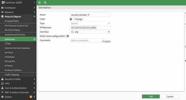

However, 'second_member_9' is not enabled with the 'allow-routing' option, refer to the below config:
    edit "second_member_9"
        set uuid a1ad73f0-8ae9-51ef-be87-2a3c20da00c5
        set subnet 10.129.0.0 255.255.240.0

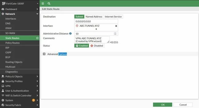

With these settings, if FortiGate firmware is upgraded then the below logs can be seen after the upgrade on the console port.
diag debug config-error-log read
>>> "set" "dstaddr" "ABC-TUNNEL-XYZ_remote" @ root.router.static.2:value parse error (error -3)
>>> "set" "dstaddr" "ABC-TUNNEL-XYZ_remote" @ root.router.static.3:value parse error (error -3)
And with the 'second_member9' address object, the destination address will be missed to update on the static route as below, with this the static route will be the default route and it may affect the traffic flow.
config router static
        set device "ABC-TUNNEL-XYZ"

If there are any address objects added to the firewall address wizard group, then make sure to enable the 'allow-routing' option.
