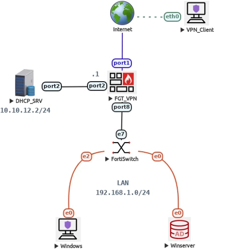

The following is the topology used for the demonstration of this feature in this article, as well as the steps required to configure the feature itself:

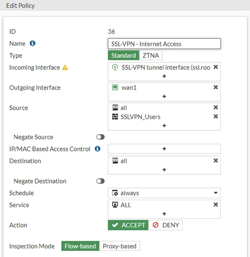

     4. Configure appropriate Firewall Policies for the SSL-VPN interface to grant access for users. A basic example is shown here:
