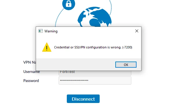

When trying to connect to the SSL VPN, the FortiClient stops at 48% and throws the error 'credential or SSLVPN configuration is wrong. (-7200)', as shown below:

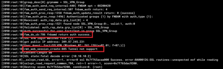

Running debug commands for fnabmd shows the authentication is successful, which suggests that the credentials are correct. However, the debug output for SSL VPN still shows the error 'Tunnel not support'.
Run the following SSL VPN debug commands:
diagnose debug disable
diagnose debug reset
diagnose debug application sslvpn -1
diagnose debug enable
The results should show the following:
This is because in v7.6.3, SSL VPN tunnel mode has been removed. As of v7.4.5 and v7.6.1, auto-upgrade is enabled for FortiGate firmware by default. FortiGate can either be manually or automatically upgraded to v7.6.3, and if the firmware is upgraded to v7.6.3, the SSL VPN tunnel mode will no longer work.
