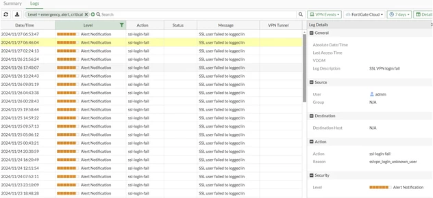

This article describes an issue where sslvpnd causes high CPU usage and VPN events show a lot of 'SSL user failed to log in' messages with random usernames.
Example of 'di sys top' outputs and VPN Events:
51U, 0N, 1S, 47I, 0WA, 0HI, 1SI, 0ST; 3962T, 1106F
         sslvpnd      194      R      98.6    10.0   1
         miglogd      337      R      2.2     1.4    0
       ipsengine      348      S <    1.8     4.4    0
       ipsengine      349      R <    0.9     4.4    0
Scope FortiGate.
A huge number of failed login attempts causes high CPU consumption because FortiGate has to validate the user's credentials.
