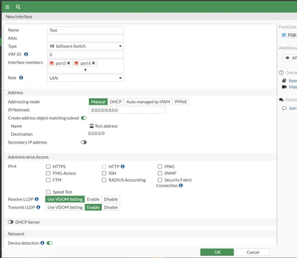

  • Create the Software switch under Network -> Interfaces, select 'Create New', select type 'Software Switch', and add the interfaces as members.
Once the software switch is created use the CLI to enable SPAN on the interfaces.

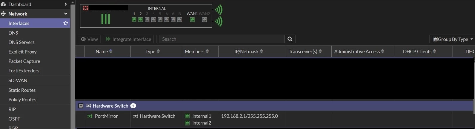

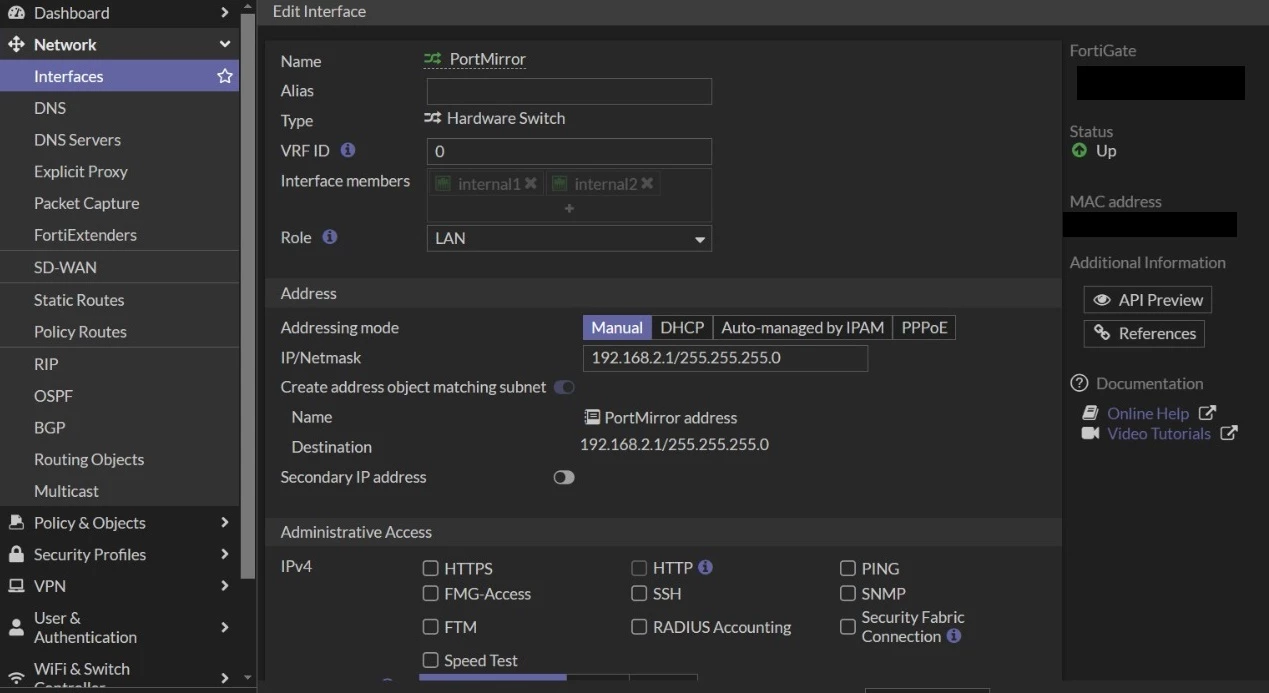

  • Create the Hardware switch under Network -> Interfaces, select 'Create New', select type 'Hardware switch', and add the interfaces as members.

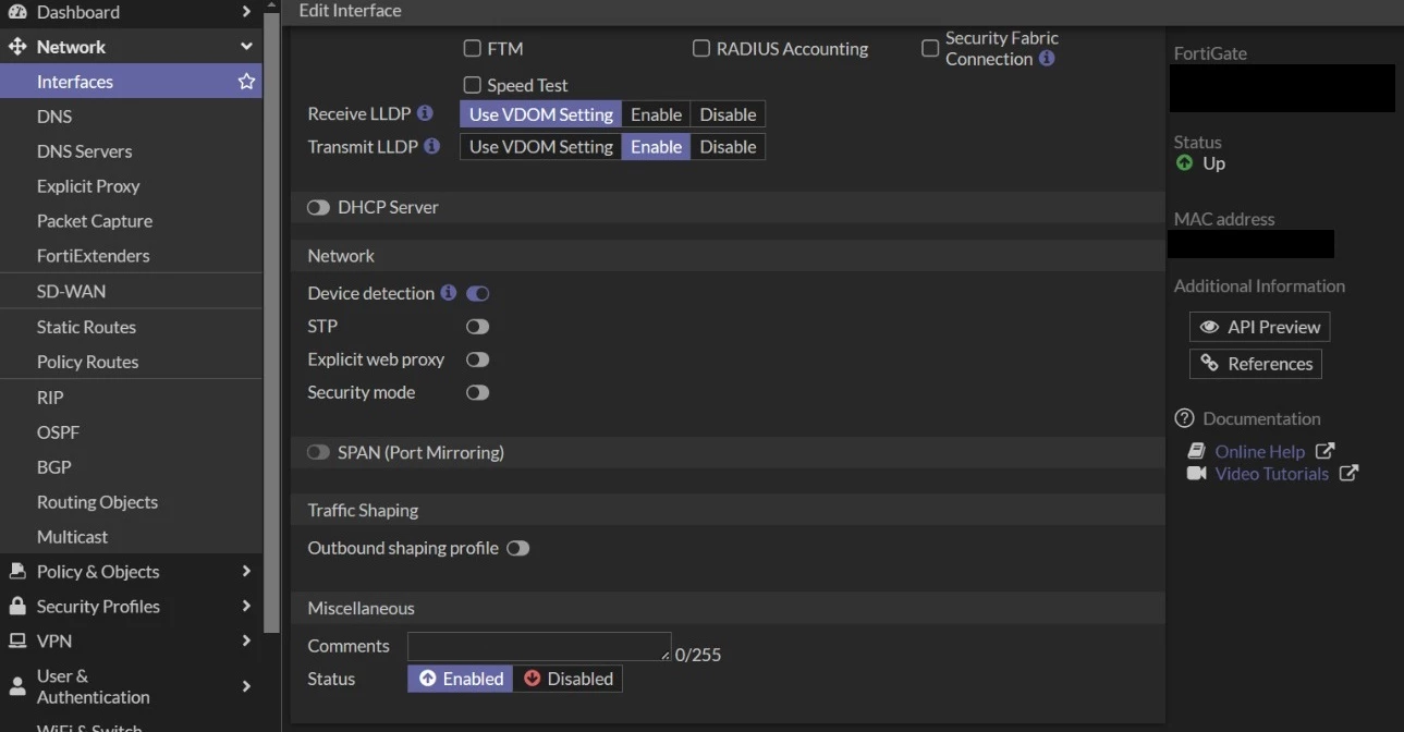

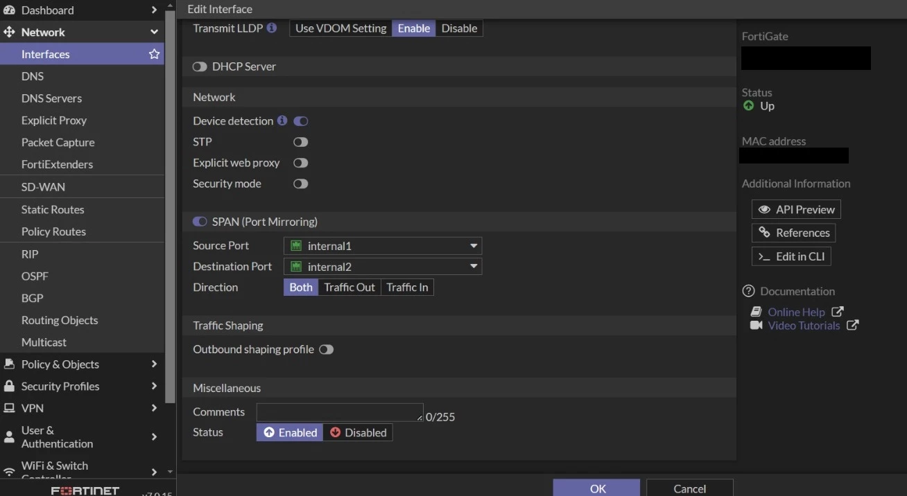

Once created SPAN can be enabled from GUI as below:
