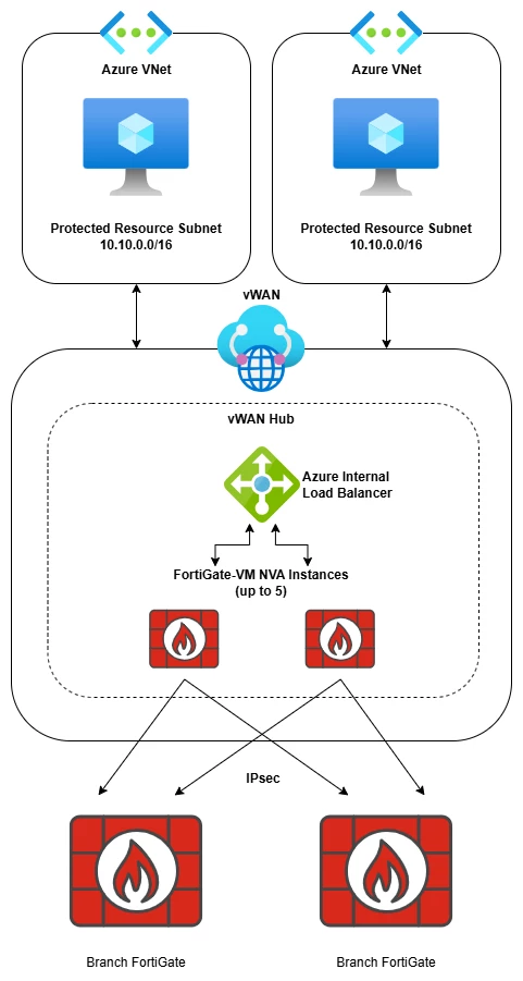

In an Azure vWAN environment with FortiGate Network Virtual Appliances (NVAs), the general topology is as pictured:
With this configuration, users located at a Branch site will be able to reach Azure-protected resources through the following flow:
  1. Users send traffic to the Branch FortiGate destined for an Azure resource.
  2. The Branch FortiGate sends traffic over one of the redundant IPsec tunnels established to the NVA FortiGate-VMs.
  3. The NVA FortiGate-VM receives the traffic and routes it towards the Azure Internal Load-Balancer (ILB).
  4. The Azure ILB forwards traffic toward the virtual host in the Azure VNet.
  5. The virtual host sends reply traffic back to the Azure ILB.
  6. The Azure ILB forwards traffic back towards one of the NVA FortiGate-VMs, which then forwards traffic back to the Branch FortiGate via IPsec tunnel (which ultimately reaches the originating client).
The final step is where issues related to asymmetric traffic can occur. Generally speaking, Azure ILBs do not guarantee symmetric traffic flow, which means that Azure can receive the original traffic from one NVA FortiGate-VM and send the reply traffic to a different NVA FortiGate-VM. For example:
  • Original direction: Client -> Branch FortiGate -> NVA #1 -> Azure ILB -> VM Host.
  • Reply direction: VM Host -> Azure ILB -> NVA #2 -> Branch -> Client.
