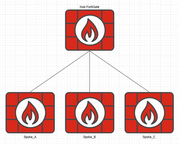

With the above in mind, consider the following example topology:
  • Hub FortiGate has a single ADVPN with OSPF tunnel configured. Spoke_A, Spoke_B, and Spoke_C each connect to that tunnel.
    • In this starting state, each Spoke will have a single OSPF adjacency that corresponds to the Hub connection, and all paths to reach other Spokes will require traveling through the Hub (i.e. Spoke-to-Hub-to-Spoke flow).

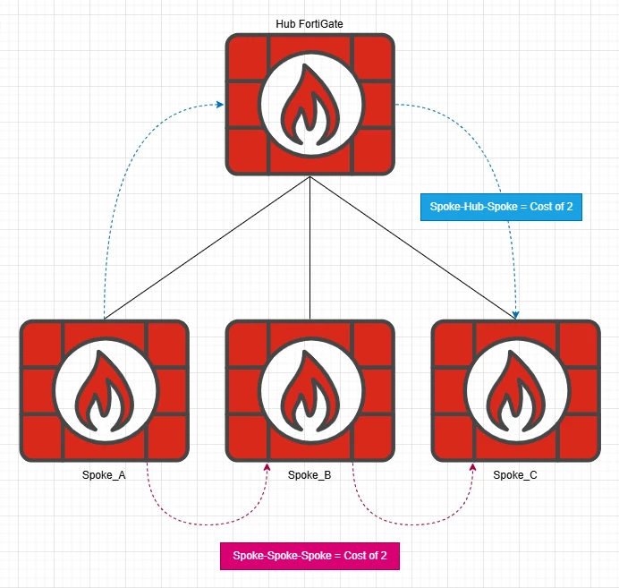

  • Later, Spoke_A sends traffic to Spoke_B and forms a shortcut tunnel. Since they are directly connected, they form an OSPF adjacency and share routes between one another.
    • This is beneficial, as Spoke_A will now have a direct route to reaching Spoke_B's advertised networks. These direct routes will have a lower OSPF cost compared to traveling through the Hub (Spoke-Spoke cost of 1 vs Spoke-Hub-Spoke cost of 2), and so Spoke_A will send traffic to Spoke_B via the shortcut tunnel. Things are working well so far.
  • Spoke_C also sends traffic to Spoke_B later and forms a shortcut tunnel as well. Spoke_B shares its own learned routes to Spoke_C, and these include the new routes that it has learned from Spoke_A as well. At the same time, Spoke_B is also sharing the new Spoke_C routes to Spoke_A since they are adjacent neighbors.
  • At this point, Spoke_A wants to send traffic to Spoke_C, and there are now two possible paths to take:
    • Spoke_A has the option of sending traffic to Spoke_C via the Hub. This has an OSPF cost of 2.
    • Alternatively, Spoke_A also has a route to Spoke_C via Spoke_B. This also has an OSPF cost of 2.
  • Depending on ECMP routing, Spoke_A may decide to send traffic to Spoke_C via Spoke_B instead of the Hub. Unless Spoke_B has been configured with Firewall Policies to allow this IPsec-to-IPsec traffic (which is unlikely since this is an unplanned traffic flow), traffic will be dropped once Spoke_B receives it.
As shown above, the issue occurs because of the following key points:
  • OSPF will allow for paths to form that bypass the Hub FortiGate, as adjacencies can be formed if OSPF is enabled and direct connectivity exists (OSPF is enabled on the parent IPsec tunnel interfaces and will be inherited by the shortcut child tunnels).
  • OSPF costs for the Spoke-Hub-Spoke path can become identical to the Spoke-Spoke-Spoke path.
  • If both paths exist, then there is a significant possibility that traffic will go in the wrong direction and be dropped.
