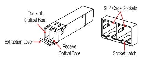

  3. Position the SFP transceiver module in front of the cage socket opening and ensure that the SFP transceiver module is correctly oriented. When the module is correctly oriented, the extraction lever will be level with the socket latch.
SFP cage socket orientation may vary.  Ensure that the SFP transceiver module is correctly oriented each time that you are inserting a module.
