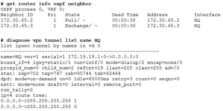

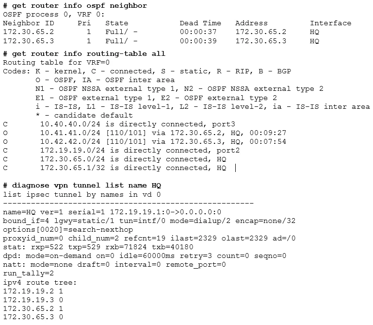

HUB:
Note.
Setting 'tunnel-search nexthop' on the Dial-up VPN configuration is necessary when using a dynamic routing with net-device disable to avoid issues.
Results when 'tunnel-search nexthop' is not implemented:
