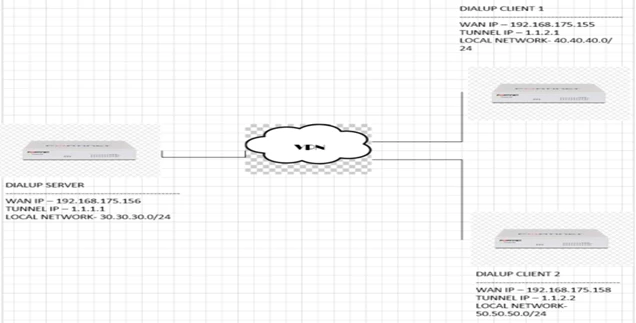

This article describes establishing 2 OSPF neighbors on a single IPsec dial-up tunnel.
For version 6.2.5.
Diagram.

DIALUP_SERVER # get router info ospf stat
Routing Process "ospf 0" with ID 1.1.1.1
Process is not up
Process bound to VRF default
Conforms to RFC2328, and RFC1583Compatibility flag is disabled
Supports only single TOS(TOS0) routes
Supports opaque LSA
Do not support Restarting
SPF schedule delay 5 secs, Hold time between two SPFs 10 secs
Refresh timer 10 secs
Number of incomming current DD exchange neighbors 0/5
Number of outgoing current DD exchange neighbors 0/5
Number of external LSA 0. Checksum 0x000000
Number of opaque AS LSA 0. Checksum 0x000000
Number of non-default external LSA 0
External LSA database is unlimited.
Number of LSA originated 1
Number of LSA received 23
Number of areas attached to this router: 1
Area 0.0.0.0 (BACKBONE)
Number of interfaces in this area is 4(4)
Number of fully adjacent neighbors in this area is 2
Area has no authentication
SPF algorithm last executed 00:10:26.870 ago
SPF algorithm executed 6 times
Number of LSA 3. Checksum 0x01cbd0
DIALUP_SERVER # get router info ospf neig
OSPF process 0, VRF 0:
Neighbor ID Pri State Dead Time Address Interface
1.1.2.1 1 Full/ - 00:00:30 1.1.2.1 tunnel netdev_0
1.1.2.2 1 Full/ - 00:00:32 1.1.2.2 tunnel netdev_1

The key configuration change (aside from the specific routing protocol config) from using iBGP, is that the server has the setting set net-device enable.
This means that for each user that dials into the server, a new dynamic interface will be created, with 'tunnel-name_index#'.
For OSPF to properly create adjacency, a new dynamic interface per spoke is necessary.
