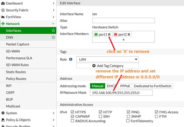

The workaround which can be applied is to remove a physical interface from the hardware-switch:
Go to: System -> Interface, select Hardware Switch interface “lan” > Edit
Then select one member which we want to monitor.
Remove the interface.
Delete the IP from the hardware-switch.
Press 'OK'

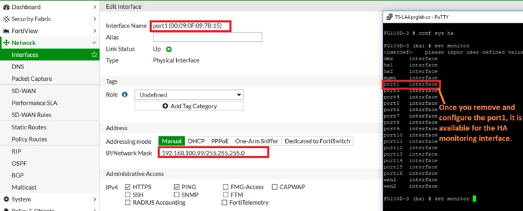

Configure the physical interface (previously removed) with the hardware-switch's IP and assign the objects references to the new interface.
Press 'OK'
This workaround cannot be applied to all scenarios since only one interface will be used and can be congested if traffic is really high, but in cases in which hardware-switch interface only has one member, there is not a problem.
