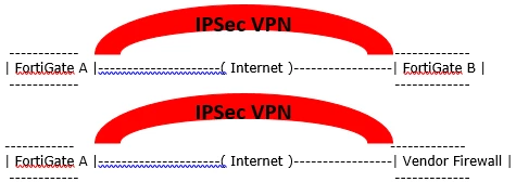

This is applicable for any site-to-site IPSec VPN between two FortiGates or another vendor.
Assuming an IPSec VPN connection to 'FortiGate B' or 'Vendor Firewall' has already been configured from 'FortiGate A'.If for any reason, the remote FortiGate/firewall unit is rebooted, an administrator may wish to have this IPSec tunnel come back up automatically, meaning before any traffic is initiated.
For this to happen, a CLI Phase 2 setting must be enabled in configuration of all those tunnels, which should automatically recover when necessary and be brought up immediately.
