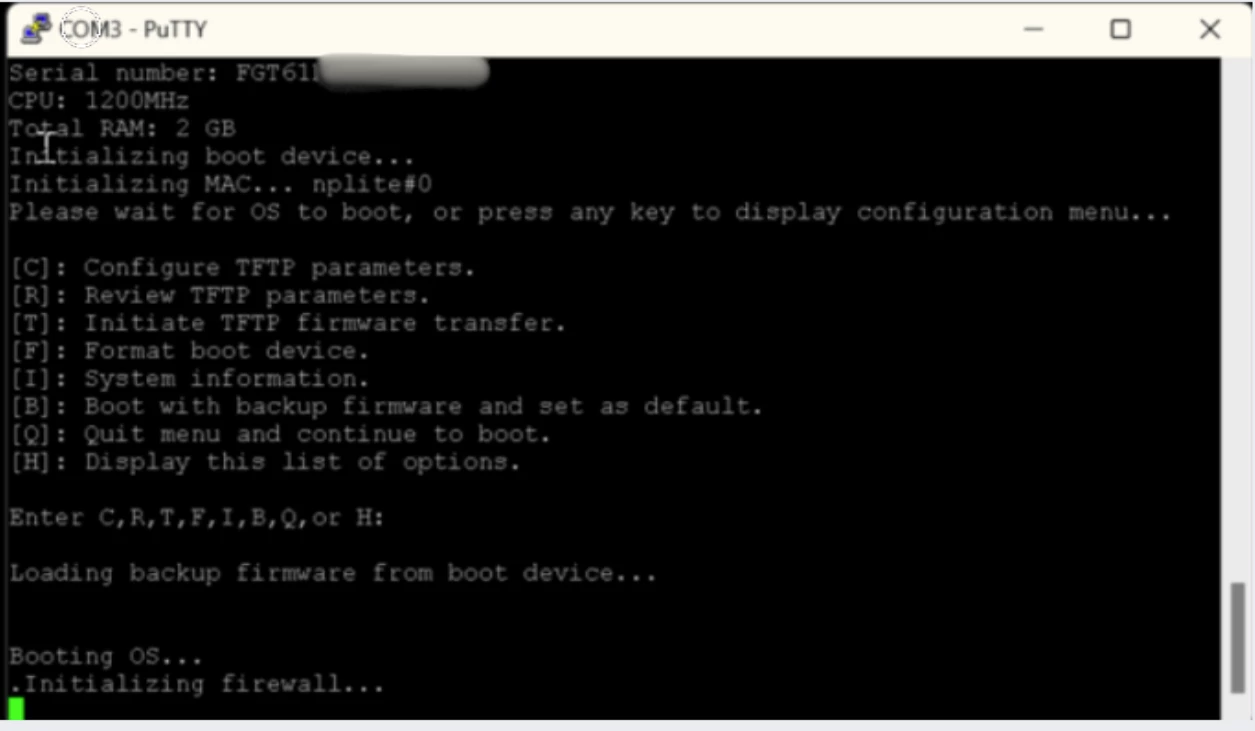

Alternative method:
Selecting an alternate firmware from the boot menu:
  1. Reboot the FortiGate ('execute reboot' or power off/on).
  2. Before it starts to boot, press any key to display the configuration menu.
  3. From the presented options, choose option 'B' to boot with backup firmware.
Once this is done, FortiGate will boot up with the backup firmware image.
