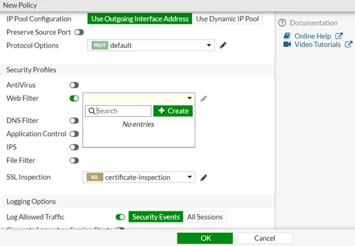

This article explains why security profiles such as AV, Webfilter, Email filter and File filter are missing after the upgrade to v6.4.x on a newly created firewall policy.

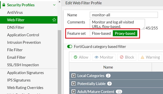

If  flow-based inspection mode is chosen on a newly created firewall policy,
It is advisable to select Flow-based feature set in order to enable this security profile in the firewall policy. And for a firewall policy in proxy-based inspection mode, select Proxy-based feature set.
After the firmware upgrade to v6.4.x if FortiGate converted a Security Profile to Proxy-based feature set, the profile will not be available/visible for use on the Flow-based firewall policies. In such cases, create a new security profile with flow-based feature-set and apply to the Flow-based firewall policy.
To learn how FortiGate converts the feature set of security profiles on the existing firewall policies post upgrade from v6.2.x to v6.4.x, please refer to the release notes.

Upgrading from 6.2.x to 6.4.0 causes the following changes to security profiles.
Upgrade scenario
Result after upgrade
Profile was assigned exclusively to flow-base firewall policies in 6.2.x.
feature-set = flow
Profile was assigned exclusively to proxy-base firewall policies in 6.2.x.
feature-set = proxy
Profile was assigned to both flow-base and proxy-base firewall policies in 6.2.x.
feature-set = proxy
Profile was not assigned to any firewall policies in 6.2.x.
feature-set = flow
