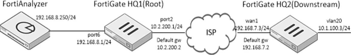

This article describes how to configure security fabric over IPsec VPN.
FortiGate.
This example topology shows a downstream FortiGate (HQ2) connected to the root FortiGate (HQ1) over IPsec VPN to join the Security Fabric:
Example configuration.
To configure the root FortiGate (HQ1):
  1. Configure interface:
  • In the root FortiGate (HQ1), go to Network -> Interfaces.
  • Edit port2:
    • Set Role to WAN.
    • For the interface connected to the Internet, set the IP/Network Mask to 10.2.200.1/255.255.255.0.
  • Edit port6:
    • Set Role to DMZ.
    • For the interface connected to FortiAnalyzer, set the IP/Network Mask to 192.168.8.250/255.255.255.0.

To configure the downstream FortiGate (HQ2):
  • Go to Network -> Interfaces.
  • Edit interface wan1:
    • Set Role to WAN.
    • For the interface connected to the Internet, set the IP/Network Mask to 192.168.7.3/255.255.255.0.
  • Edit interface vlan20:
    • Set Role to LAN.
    • For the interface connected to local endpoint clients, set the IP/Network Mask to 10.1.100.3/255.255.255.0.
