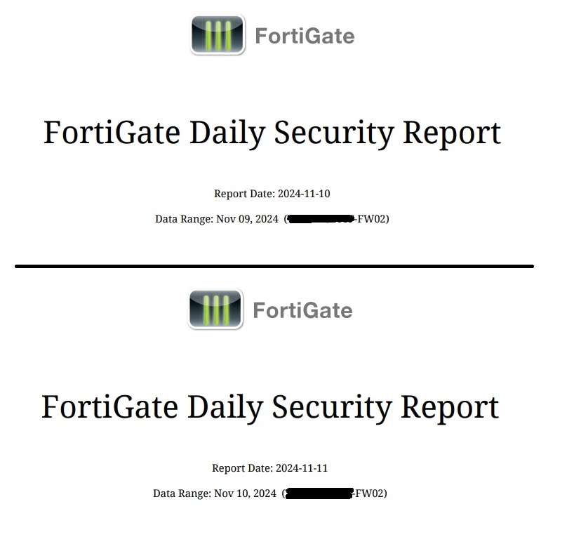

Description This article describes how to stop high availability (HA) secondary unit sending daily local report automatically.

The false trigger of the daily report from the secondary unit can be observed especially in firmware v7.4 even if it is not configured as 'daily':
If the unit is running in Active-Passive mode, it can be resolved by login from primary to secondary unit using commands as shown in this KB article: Technical Tip: How to access secondary unit of HA cluster via CLI
Reboot the unit using the command 'execute reboot', enter, and then press 'y', it does not require downtime since it is a passive unit.
