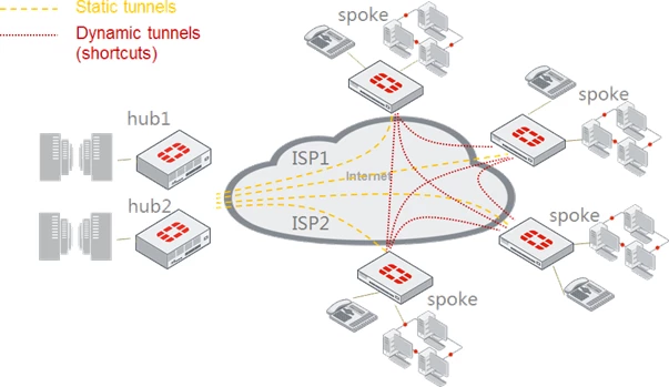

This article describes how to configure the setup of SD-WAN for ADVPN.
With this feature, SD-WAN service rules can utilize the shortcut VPN to forward traffic between spokes.
Previously, spoke-to-spoke traffic could only be forwarded by the hub, and could not take advantage of the ADVPN feature.
FortiGate.
This user ADVPN with SD-WAN scenario uses two hubs.
Each spoke connects to two ISPs and establishes VPN tunnels with each hub.
SD-WAN is configured on the spokes and uses two VPN interfaces as members with rules to control traffic to other spokes via the ADVPN shortcut VPN interfaces.
