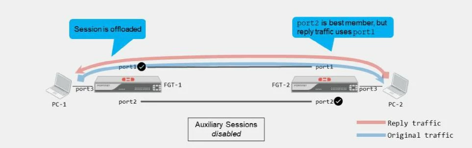

Consider the scenario below with 2 FortiGates (FGT-1/FGT-2), which are connected by 2 SD-WAN members, port1/port2.
PC1 behind FGT-1 sends traffic, which is routed by FGT-1 using port1. Traffic is received by FGT-2 using port1, but then an SLA change happens at FGT-2, and port2 is now the preferred port for return traffic.
By default, when performing route lookups for reply direction, FortiGate considers only routes through the same ingress interface used in the original direction.
This is done to preserve session symmetry; however, this also prevents reply traffic from switching to a better-performing member, which can impact sensitive applications such as voice and video.

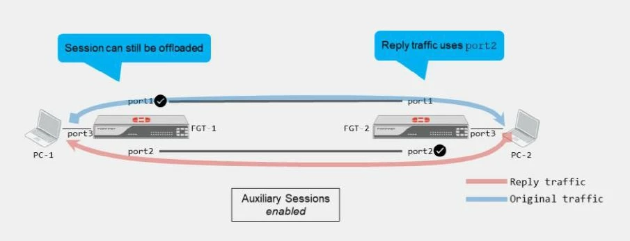

Now, when enabling Auxiliary Sessions on both FGT-1/FGT-2, 2 issues can be resolved:
  • FGT-2 can route back the reply traffic using port2, which is the best-performing member.
  • FGT-1 will create an Auxiliary session (reflect session) and allow the asymmetric traffic to be offloaded to hardware. If not enable,d auxiliary sessions on FGT-1, FGT-1 use the system CPU to handle asymmetric traffic.

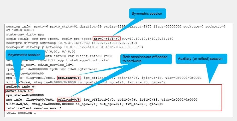

The output below shows how the auxiliary session looks on FGT-1:
The session was established initially symmetrically from port3 to port1 (interface index numbers 7 and 5, dev=7->5/5->7). After that, FortiGate received a reply packet on port2, which triggered the creation of an auxiliary/reflect session (dev=7->6/6->7), which is attached to the same session.
Note that an auxiliary session is not a separate session. It is an extension of the main session used for asymmetric traffic.
It is showing interface index numbers 7 and 6, both sessions are offloaded to hardware, which results in higher performance.
