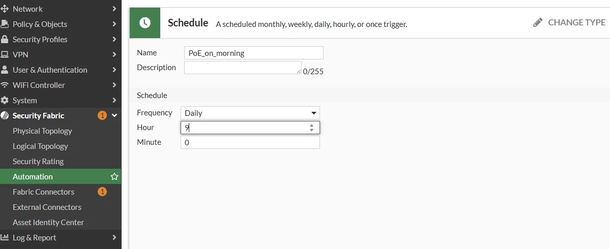

  1. Go to System -> Automation Trigger and create a new trigger. Set the trigger type to 'scheduled' and configure the trigger frequency, hour, and minute according to the requirements.
Using the CLI:
    edit "PoE_on_morning"
        set trigger-type scheduled
        set trigger-frequency daily
        set trigger-hour 09
        set trigger-minute 00
    edit "PoE_off_evenings"
        set trigger-hour 18

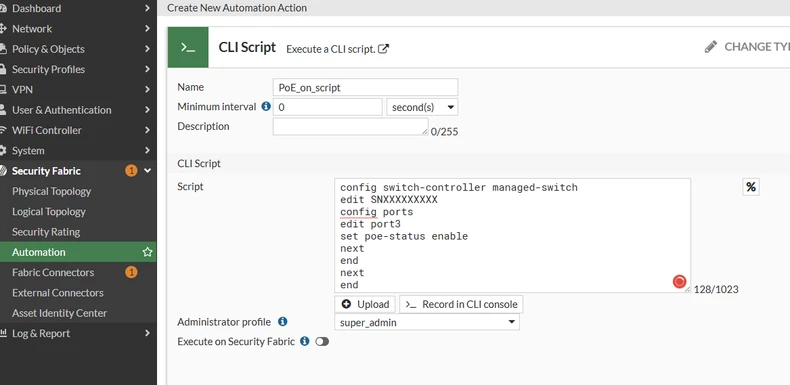

  1. Go to System -> Automation Action and create a new action. Set the action type to 'cli-script' and configure the script to enable or disable PoE on the desired FortiSwitch port. Make sure to change FortiSwitch SN and also edit port list. Port3 is taken as an example, but the full port list can be configured the same way as doing it manually.
Using the CLI:
config system automation-action
    edit "PoE_on_script"
        set action-type cli-script
        set accprofile "super_admin"
        set script "
            config switch-controller managed-switch
                edit <FortiSwitch_serial>     <----- Change FortiSwitch serial number.
                    config ports
                        edit port3
                            set poe-status enable
    edit "PoE_off_script"
        set script "
                    config ports
                        edit port3
                            set poe-status disable

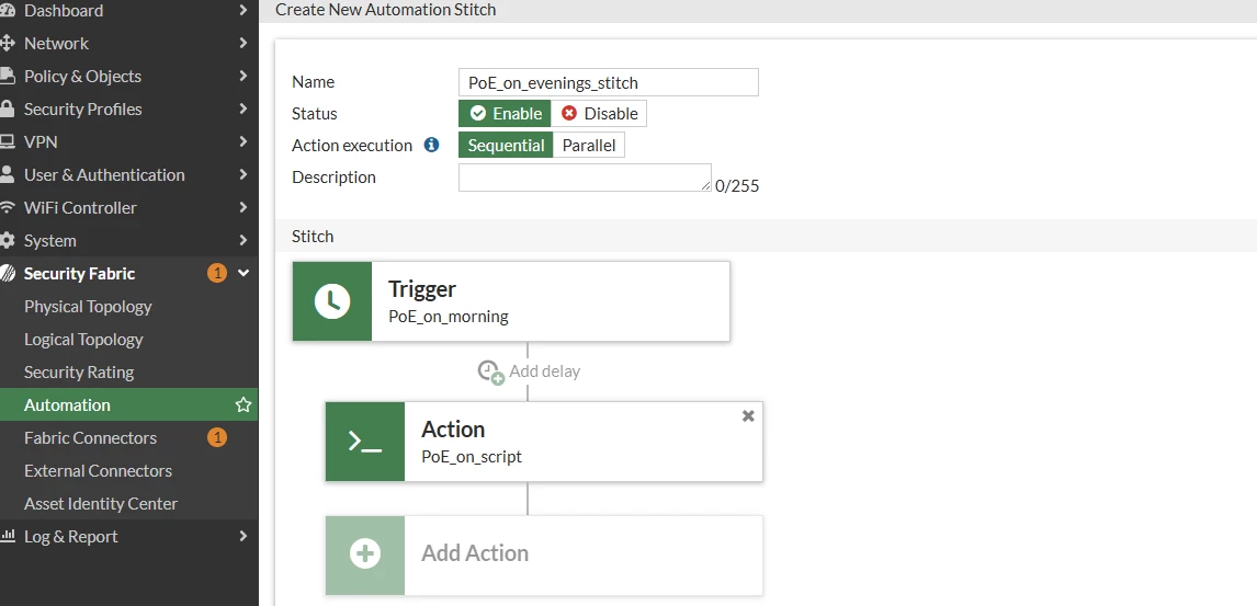

  1. Go to System -> Automation Stitch and create a new stitch. Tie the scheduled trigger and CLI script action together, and set the required option to 'enable'.
Using CLI:
config system automation-stitch
    edit "PoE_on_evenings_stitch"
        set trigger "PoE_on_morning"
            config actions
                    set action "PoE_on_script"
                    set required enable
    edit "PoE_off_evenings_stitch"
        set trigger "PoE_off_evenings"
            config actions
                    set action "PoE_off_script"
                    set required enable
