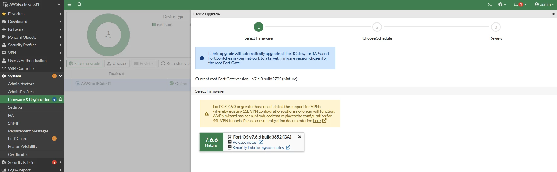

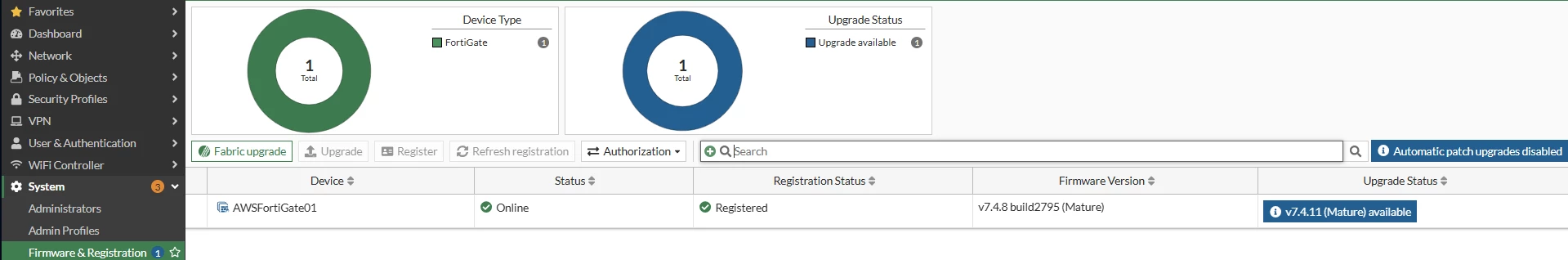

  • For v7.4.x, firmware upgrade under System -> Firmware & Registration -> Fabric upgrade.
  • Check the screenshots below showing the upgrade procedure in v7.4.x.
  • Go to Select-Firmware -> All Upgrades.

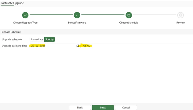

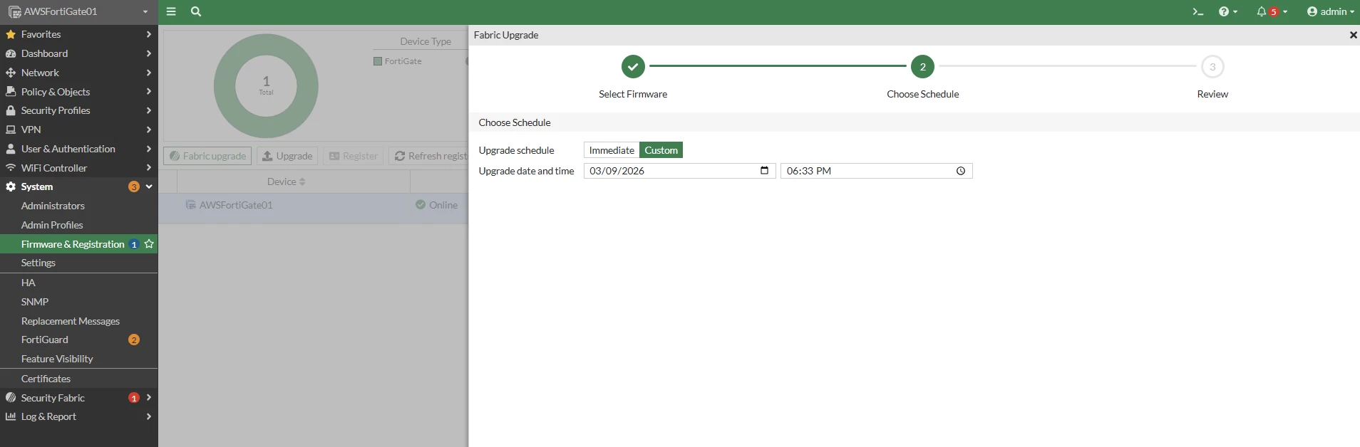

  • Choose Schedule -> Custom -> Select Date and time.

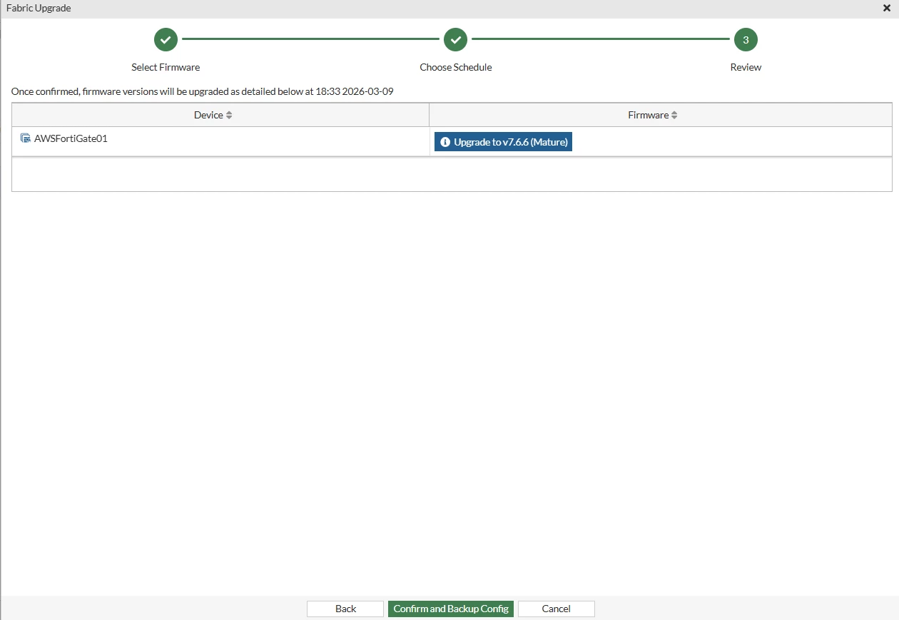

  • Select Confirm and Backup Config.
  • Confirm Upgrade Status with the scheduled date.
